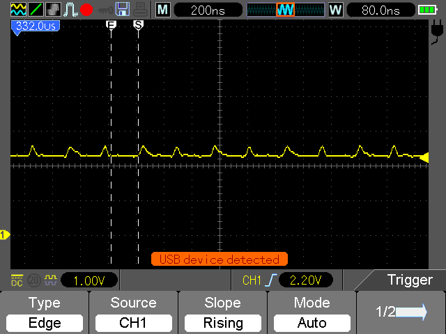

We have an unexpected output behaviour after local cooling. We use LMV358 as simple inverting amplifier, Au=10, Vcc=5V.
  • Problem seems to be a hidden defect, demonstrable either by low temperature (-30 degC), high temperature (60 degC) or load test, or combinations thereof.
  • Problem isn’t connected to design and PCB layout
  • Problem is specific for limited quantity of LMV358IDR by Ti
  • THe issue has 10 percert of LMV from the reil
Normal function:
After local cooling:
Anyone knows about this issue?
