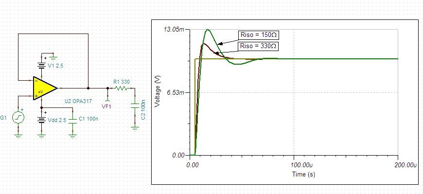

In a design I am using OPA4317 as unity gain buffer. I am using single supply 3.3V. I want to drive 0.1uF capacitor with it, what should be the value of isolation resistor so that this design doesn't face instability. Does it depend on signal frequency.
Prashant Tripathi
  • Hello Prashant,
    You can simulate the stability of the OPA317 driving a 0.1uF capacitor using the free SPICE simulator TINA-TI.  For more information on the stability analysis techniques used for these results, watch the TI Precision Labs Videos on Op Amp Stability:
    We recommend using somewhere between a 150 and 330 Ohm resistor depending on the type of response you're looking for.  See below:
    1205.Circuit.TSC

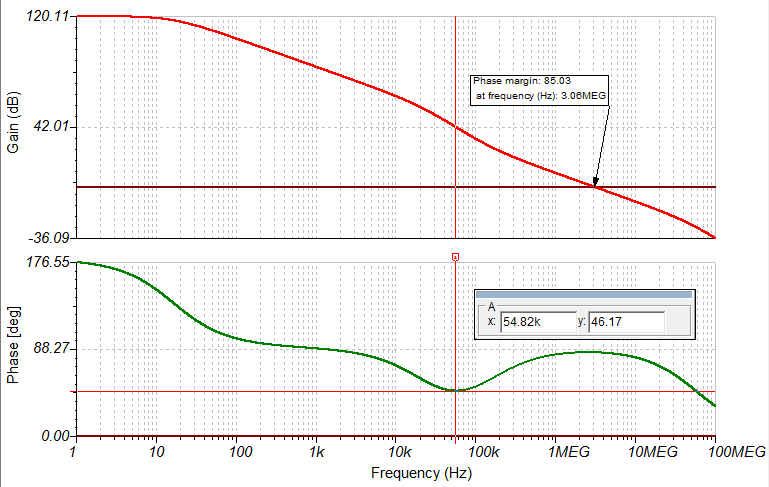

    The OPA4317 is a low offset chopper amplifier and is most suitable for DC applications. To drive a capacitive load, a better solution would be to use an OPA627 or OPA625. You could use a much smaller isolation resistor in this case as well. Please see the simulation results below:

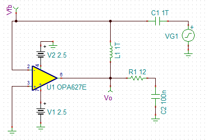

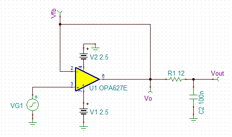

    Schematic:
    Loop gain and Phase Margin analysis:
    Results:
    As seen, the Phase Margin is well above 45 degrees.
    Transient response:
    Transient response using a 50kHz square wave on the input.
    As seen, the results are very stable and there is only a slight overshoot.
