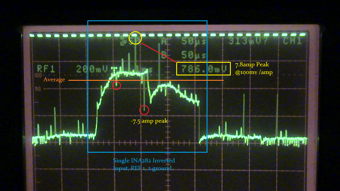

    This scope captured envelope 2x seems to indicate a Single low side INA282 is capable of measuring half bridge Bipolar current in both directions. So it appears the high side FET and low side FET current artifacts exist in a bipolar division developed in the INA switching capacitors. There is no need for summation unless it provides some kind of benefit not yet answered in the posted question.
    This blue square represents the PWM wave form event of the Bipolar FET half bridge and the yellow/red circles indicate bipolar 80us/12.5kHz PWM periods. The main voltage rise sets the current threshold and the pulses seem to indicate bipolar FET avalanche current is detected without summation. What is missing in this capture is a sample hold of any linear ratio metric voltage slope in the INA282 output, that which summation may provide?

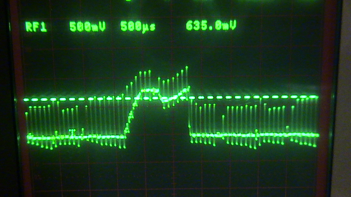

     Captured signal 2015 data sheet Kelvin connection (-IN) via to ground plane seemingly picks up both sides of the Bipolar switching artifacts.
    Same signal with very thin gage wire 0.250" long (twisted pair) lead into shunt Kelvin connection:
  • You meant, 7.8 Amp peak @ 100mV/Amp. (not 100mV/volt)
    My read of that trace suggests those 2 red highlights are ~1 hor. div. apart - that's 50µS - is it not? No yellow circles are visible - my monitor...
  • 80us is the pulse width of any single pulse. Tektronix storage display playback 1987 did not change the horizontal time base to reflect save history. 1 yellow circle very top is 80us pulse. Other 80us pulses exist outside the blue box exist outside the ADC sample window.  Those stray pulses are seemingly artifacts occurring from 2 other active phases sharing a Delta phase coil array.
