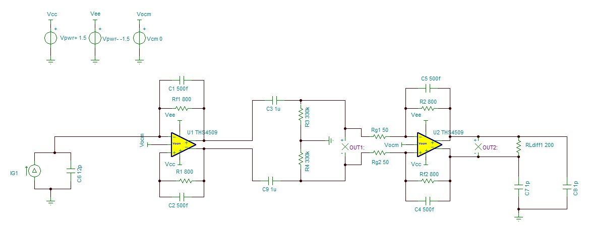

  • Let me put it very clearly ,
    the signal i get from photo diode is arround 50nA so i should atleast have a gain of 120dB that is 12M of transimpedance gain to process such a small signal,
    very important thing is that signal comes at a freq of 100MHz because its a pulse of 10ns
    you may ask me what is your plan on noise, i will put a pair of FET at photo diode output to avoid excessive noise, leave it aside lets comeback
    what happens if i put a 12M gain to my TIA, with OPA659 and even THS4509 what i observed is if i go for huge gains my signal at 100MHz will die

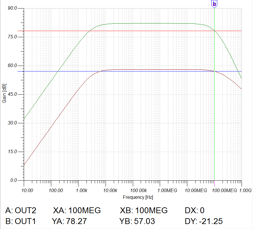

    see the response with THS4509

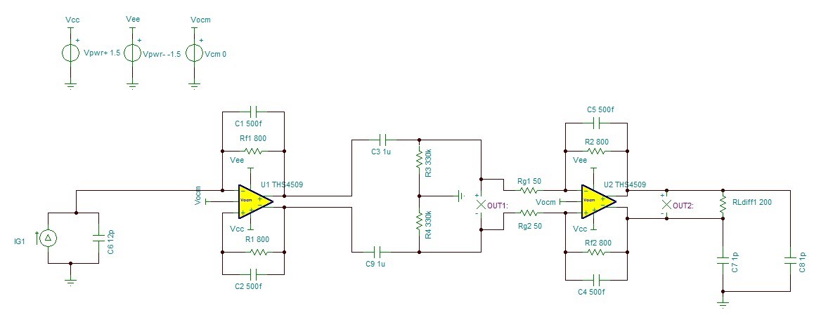

    Circuit:
    Note the circuit i attached will have mechanism to handle excess input voltage noise(kindly find any mistakes if there )
    Response at Rf being 800
    result at Rf being 1K and 1K
    so just imagine what happens if i put a feedback of 12M to primary TIA itself, the response will be very poor,
    so typically i need  a >100dB gain at 100Mhz so i can say my GBWP to be 10^10 !
    any way the opamps you suggested will not be able to satisfy these needs,
    in a nutshell i want the pulse of 10ns to retain its shaped even after going through TIA stage and amplifier, provided the pulse is minimum 50nA to be processed

    Note: please find the attached ckt alsoDEMO_THS4509_TIA.TSC
  • With 12pF of input capacitance from the photodiode + 2pF of input capacitance from the opamp (just assumed a low number here for a hypothetical opamp), for 100MHz of closed-loop TIA BW, even with 5kOhm of feedback resistance an opamp with a gain bandwidth of 4.4GHz is needed. Please see this blog post and the link at the end for an excel calculator which makes the calculations I just described.

    Your restriction here is going to always be the GBP of the amplifier and not the slew-rate. The fastest opamp we currently have is the LMH6629 and the OPA857. I have some test data with the OPA857 with a 10pF input capacitor and that has a bandwidth of around 110MHz with 5kOHm feedback resistance. So I would recommend this as the 1st stage TIA. For the second stage I would recommend either the LMH6629 or OPA847 in a non-inverting configuration.
    This is the best suggestion I can think of right now.
    -Samir

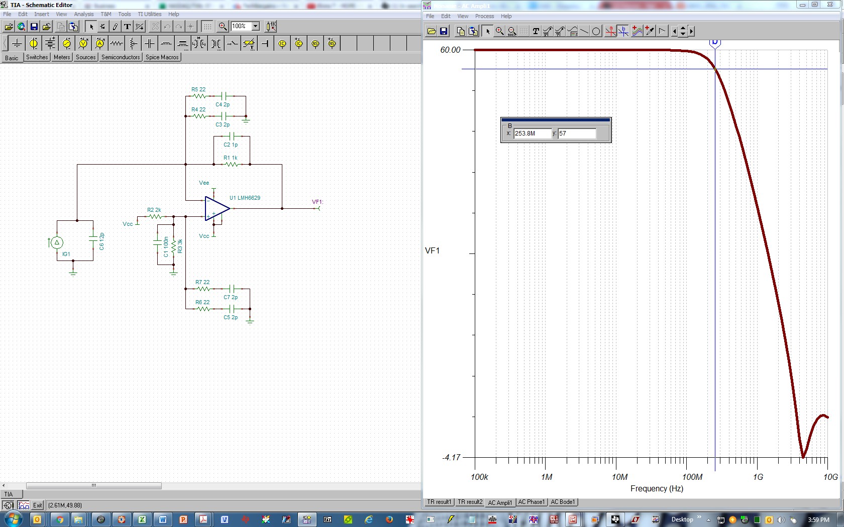

  • Hi sameer ,
    here i picked LMH6629 and used the same TIA configuration as suggested but i was unable to see the output, its just noise only
    please find the attached circuit and help me TIA.tsc
  • Hi Daram and Samir,
    The problem with the LMH6629 TINA-TI simulation file was that the current source was set to off:
    Here is the AC response with the current source state changed / corrected (set to "None" instead):
    Here is the new simulation file for reference:
    TIA modified 5_17_16.TSC
