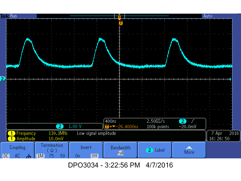

I am seeing a strange oscillation on the output of my THS4131.  I am using the op-amp as a I/V converter in single-supply mode with +5V.  My feedback resistor is 500 ohms and my source resistance is about 5 ohms.  My input now is just white noise, but the output looks like the attached picture.

    That doesn't look like a typical oscillation. Can you post a schematic? What is your current source?

    Thanks for the reply.  My schematic and datasheet excerpt are below.  My feedback res is 500ohms, the feedback caps are removed and the AC coupling cap is shorted. OPAMP+ is +5V and OPAMP- is tied to GND. I don't have pull-up resistor as suggested in the application circuit, nor do I have any load.  The device output is current mode so I don't want an Rg. As you can see, we are trying to use the THS4131 as the I2V Sum amp seen in the datasheet circuit. Also, VocmI is 0.9V

  • I guess e2e still hasn't figured out copy and paste.  Please see attachment below.  Also, my circuit seems to work fine with +/-5V supply.

    From the datasheet it looks like the Vocml is too low. The outputs can only swing to about 1V from the rail. That means with a Vocml of 0.9V there is no swing left on one of the outputs.
    I would advise against having no load. At least a 1k Ohm resistor would be good.
    I understand a current amp should not have an Rg, but then the voltage gain is infinite and the Vos will get gained up. There needs to be some way to null out the offset voltage.
    Is there a reason you don't want to use +-5V? Nearly all ground referenced applications are much easier with split supplies.
