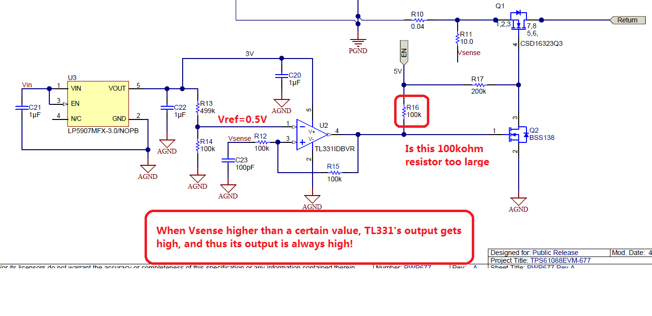

TL331 in deadlock application
Other Parts Discussed in Thread: TL331
Here I want to ask a question about the comparator TL331 in deadlock application. Could this comparator still realize the dead-lock function with the following weak pull-up? Please help to check the following schematic. This schematic is   for powerbank and bluetooth speaker application.
