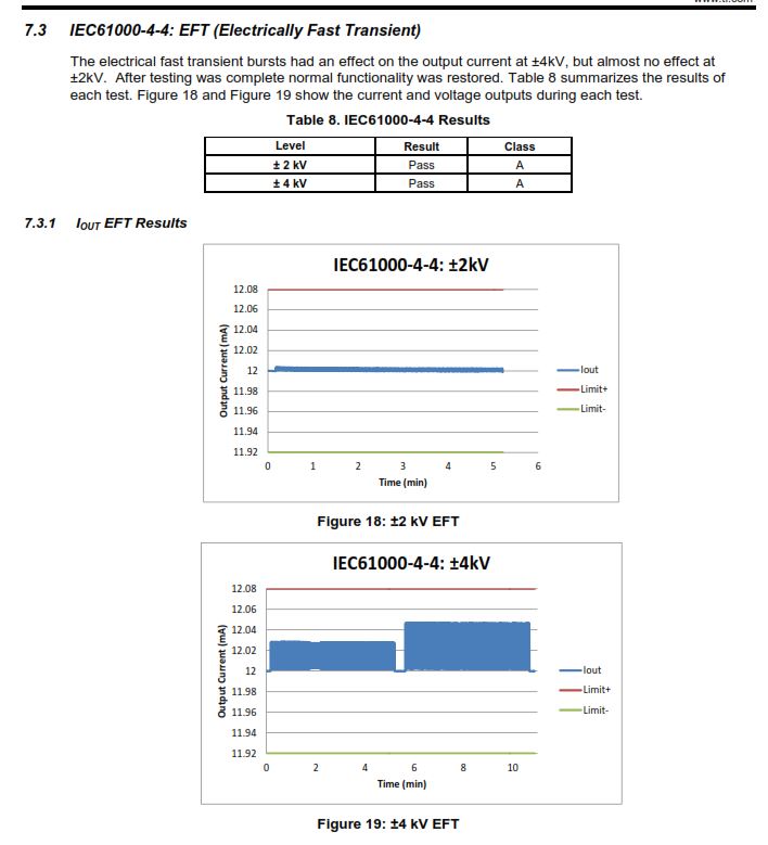

I'm using XTR01 for 0-150°C to 4-20mA current converter. Recently I have replaced the XTR101 circuit with XTR105 & the out put are satisfied with the new chip. While conducting EFT test with the new XTR105 circuit, it fails at 2KV capacitive coupling EFT test, where the XTR101 can pass the EFT test @ 2KV. I have attached the schematic of XTR105 & the protection circuit same for old XTR101.
Do you have any recomendation for the protection circuit. The same circuit withstand 2KV signal surge. Only fails at EFT.
