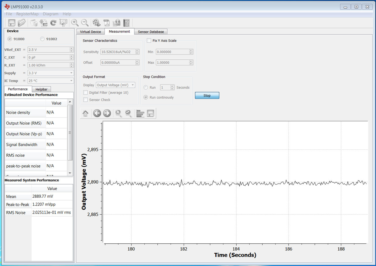

I have LMP91000EVM board with me. I have configured it for 2 lead galvanic cell in potentiostat configuration.
In place of sensor I have connected simple resistance of 15K between WE and CE/RE terminals. I have configured transimpedence amplifier with load res of 10E and gain res of 2.75 K .
Applied bias voltage is 0.4 V and internal zero voltage is set to 50% of supply (+5V).
I can see the current of 24 micro amp. on the galvanometer connected between resistance and WE terminal. (Galvanometer range 100 micro amp).
My problem is output voltage I see at C2 or Vout pin does not match with theoretical calculations.
I am using equation (Vref - Vout)/RF = I
Practically I observe 0.975 V as output voltage.
Further If I vary resistance connected between WE and CE/RE terminal then current vaties , but output voltage at transimpedance amplifier does not change.
Please tell me what is going wrong.
