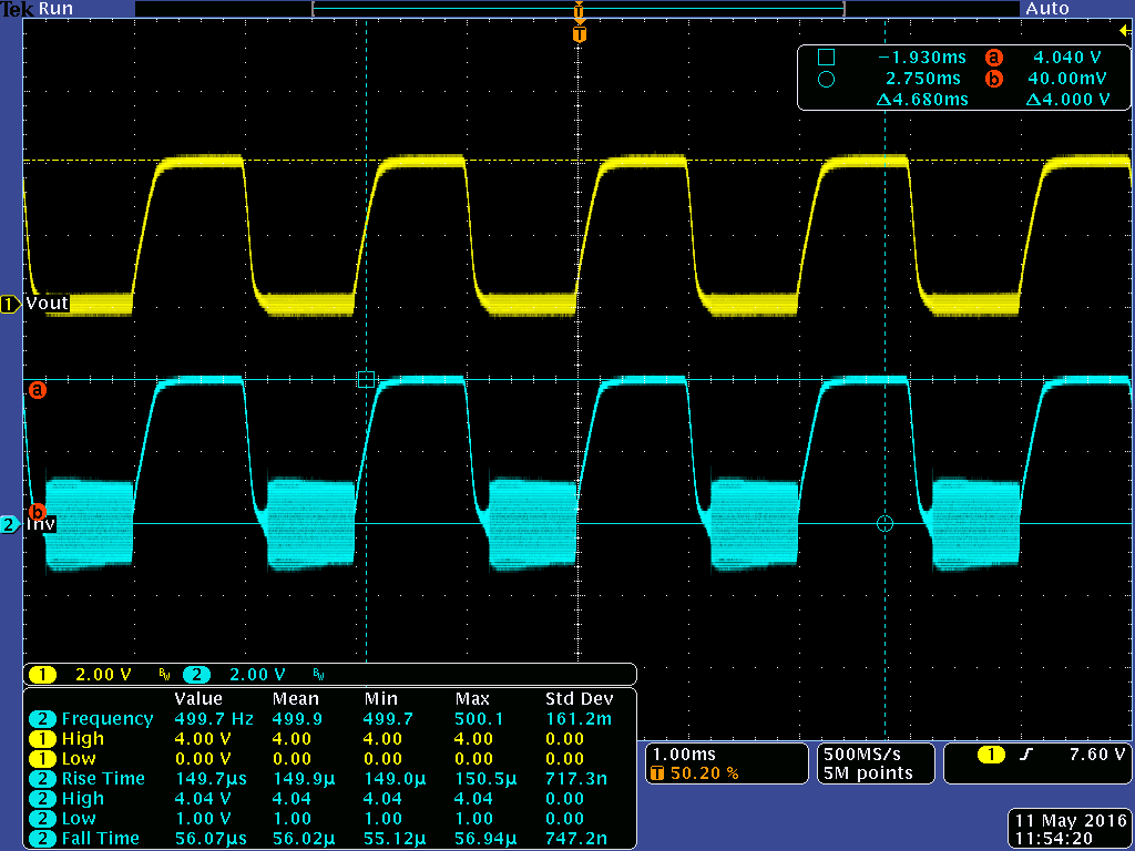

I am looking for a high speed operational amplifier, with supply voltage range +15 to -15 or specifically 0-15 V should be fine.
My application is to maintain the value at the inverting terminal equal to that at non inverting terminal. To develop voltage at inverting terminal equal to that at non inverting terminal, output should go high that would be given to the gate of a mosfet, which then would allow some current flow through the mosfet. The inverting terminal would be connected across a current sense resistor, through which this current is expected to sink. So, ideally whatever voltage is there on non inverting terminal is expected to appear across this current sense resistor.
This application is a constant current load.
Also, the slew rate of the opamp should be high enough.
One op-amp that I could figure out is LM7171, but its slew rate depends on differential input voltage.
TLE2142 is yet an another opamp, but has less slew rate.
Look forward to get suggestion for some suitable part.
