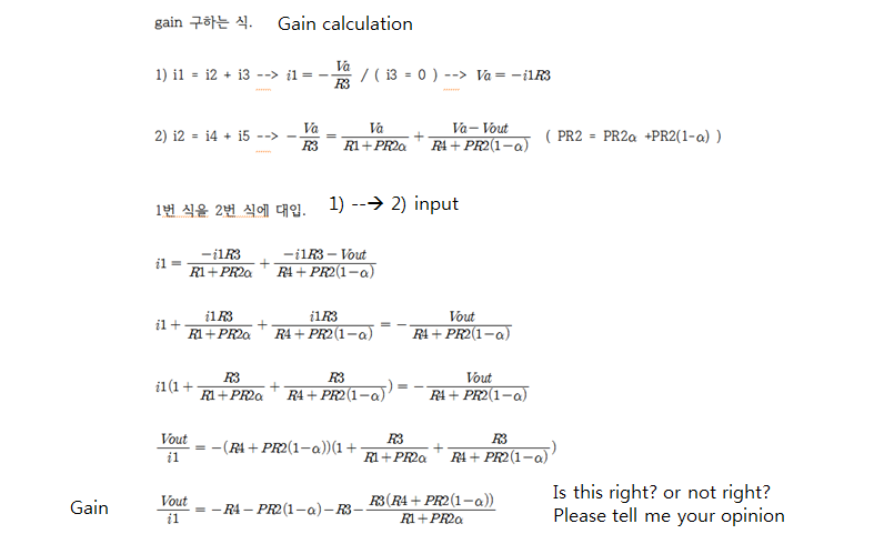

Inverting transimpedance amplifier calculation
Thank you read above writes
