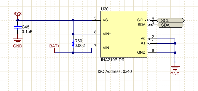

I'm having an issue where I cannot seem to change the register pointer address to read the value in the current-register. Here's the schematic of my circuit, it's exactly as in the app note:

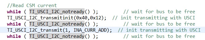

The only initialization I do is change the configuration/calibration registers as noted in the app note:
Code:

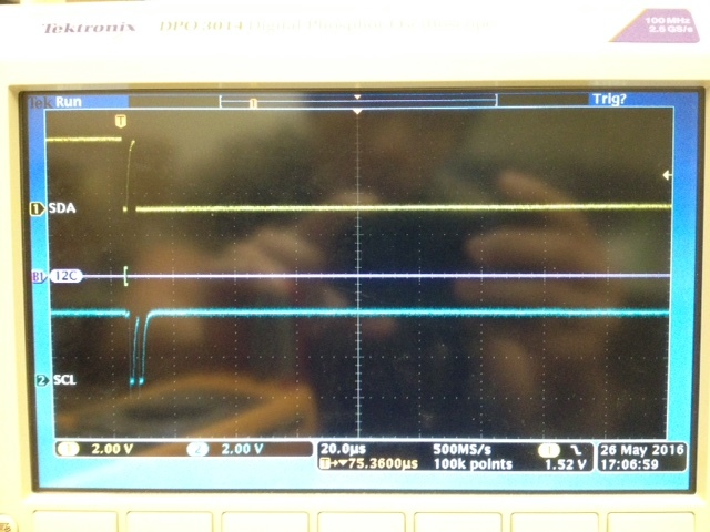

The scope shows successful transfer:
But when trying to change the pointer by sending the register address (0x04 in the current register's case):
I only get this:
If I try to read back two bytes without changing the register pointer, it does so successfully (it'll repeat what I just wrote to it). Does anybody know what it is doing this? Thank you!
