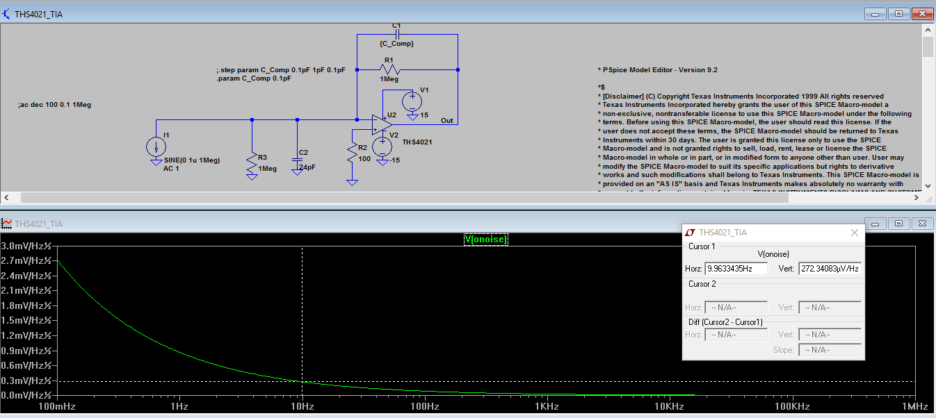

Above is the circuit I simulated.
I used the THS4021 as an op-amp in a transipedance amplifier (TIA) circuit. The noise from 0.1 Hz to 10 Hz is higher than I want. The noise at 10 Hz though appears to be higher than the data sheet says it should be. Looking at the current noise plot in the data sheet (Figure 27) shows that the current noise at 10 Hz is about 30 pA/rt-Hz. My simulation using the THS4021 PSPICE model (in LTSPICE, sorry...) indicates that the current noise at 10 Hz is about 10x higher.
Does TI have another op-amp that is similar to the THS4021 (which I like because I have gotten it to be stable in the past, whereas some of the other ultra-low noise, very high BW Texas Instruments' op-amps oscillated on me) that has lower low frequency noise. I like the 2 nV/rt-Hz Vn of the THS4021.
