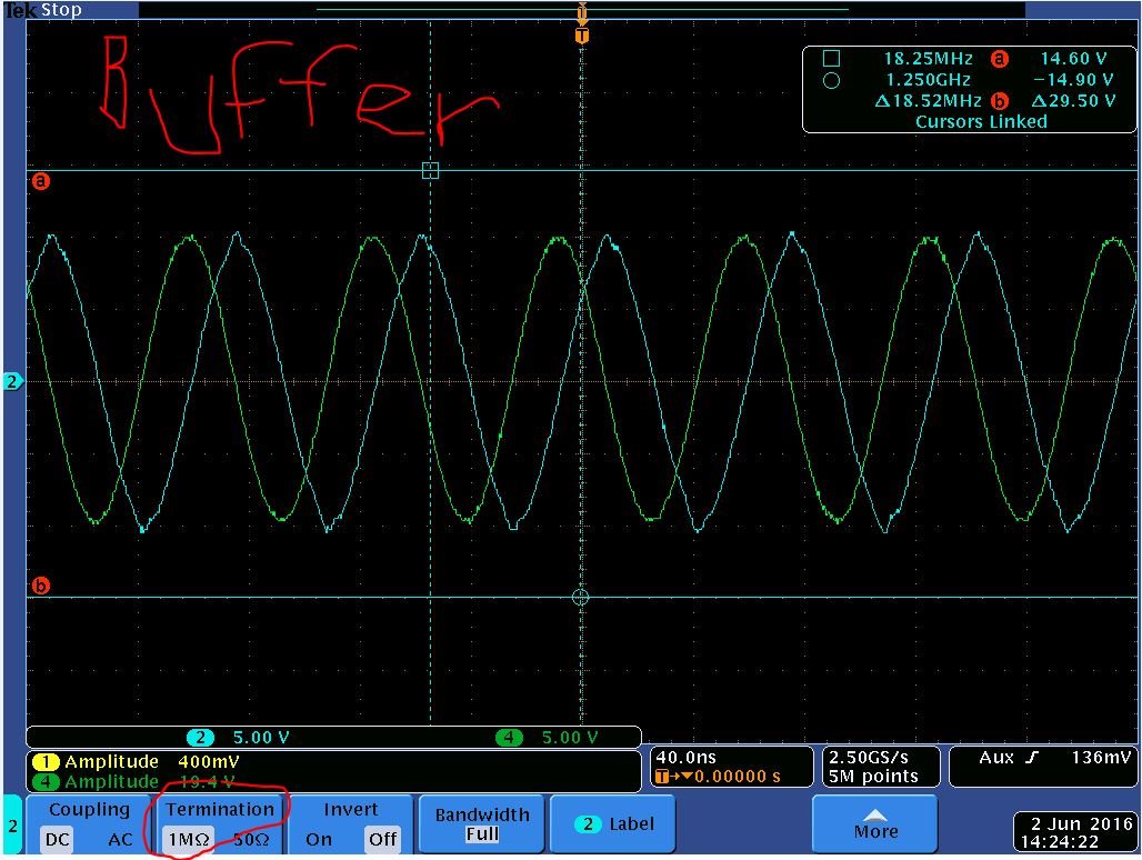

I'm having difficulty getting a clean 20Vpkpk Sine Wave @ 15 MHz out of my THS3092 hooked up in a unity gain buffer (with Rf=1.1K) into a high impedance load (playing with load impedance; somewhere between 1KOhm and 10KOhm).
@1 Kohm load I can get a clean sinewave up to around 16-18Vpkpk. The THS3092 output swing is specced up to ~24Vpkpk over temperature.
This application is a peak detector, so Sinusoidal linearity (Distortion) and voltage dynamic range are important.

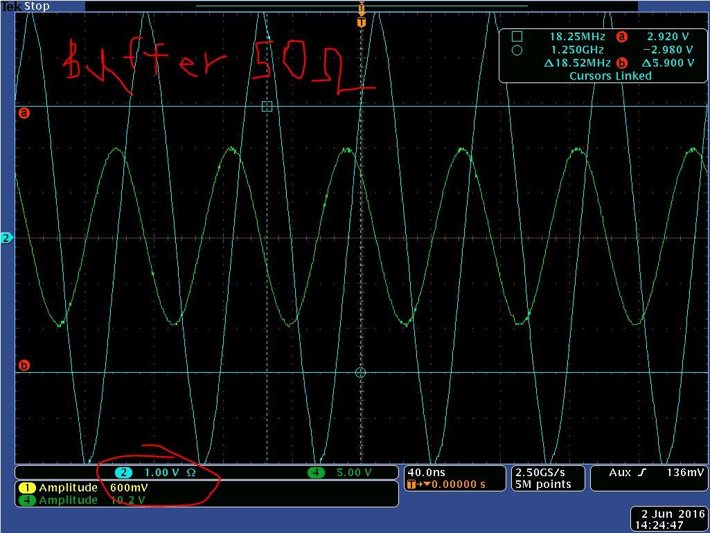

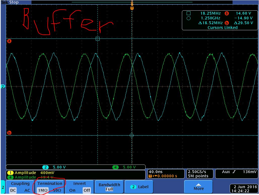

  • I tried configuring the EVM as a buffer to drive either a 1MOhm (Hi-Z scope) load, or 50-Ohm load (50-Ohm Scope). (see waveforms)

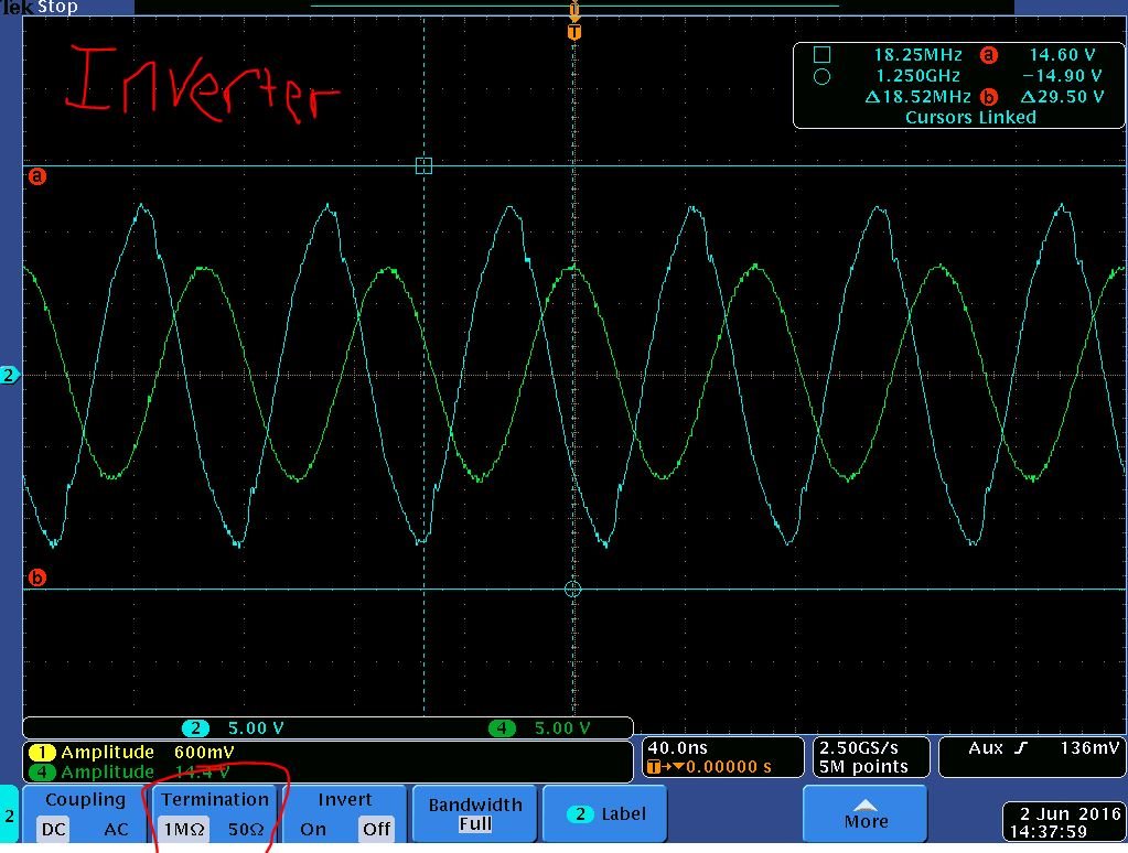

    I also tried the EVM in gain as -1 and saw no improvement. (see waveforms)
    Your datasheet claims up to ~ +/-12V and -45dB @ 15MHz. I could be wrong but I would think -45dB would be enough to prevent this distortion I am seeing. I will try to load-share the THS3091 but am not expecting improvement as I already tried it with the THS3092...

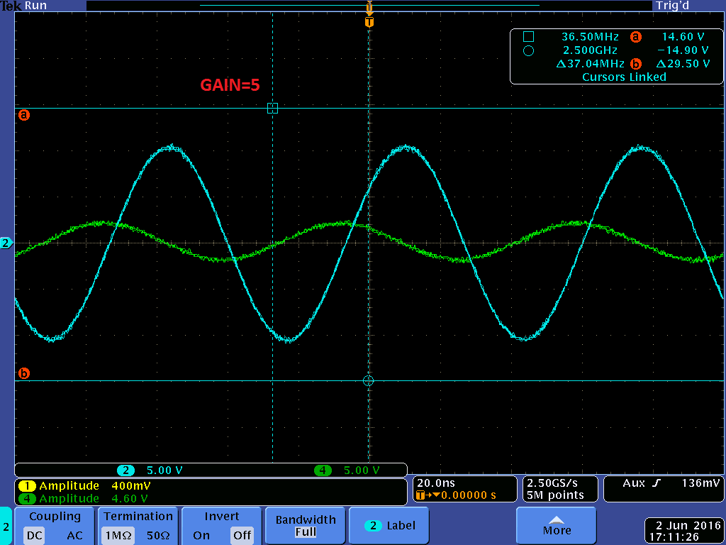

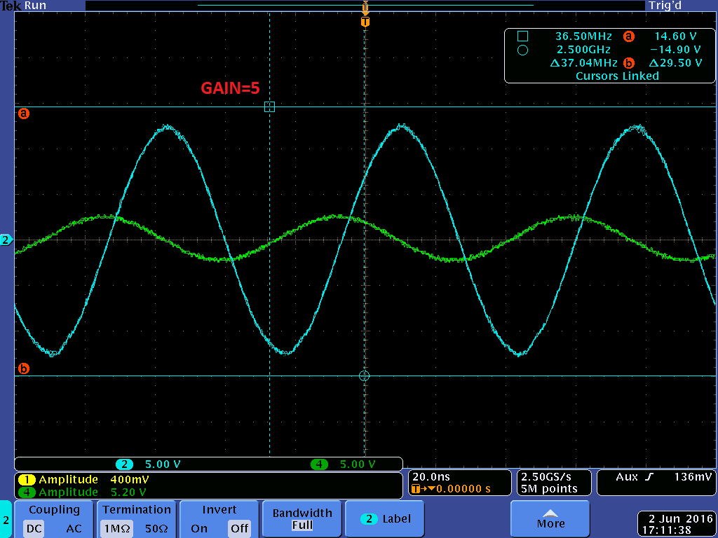

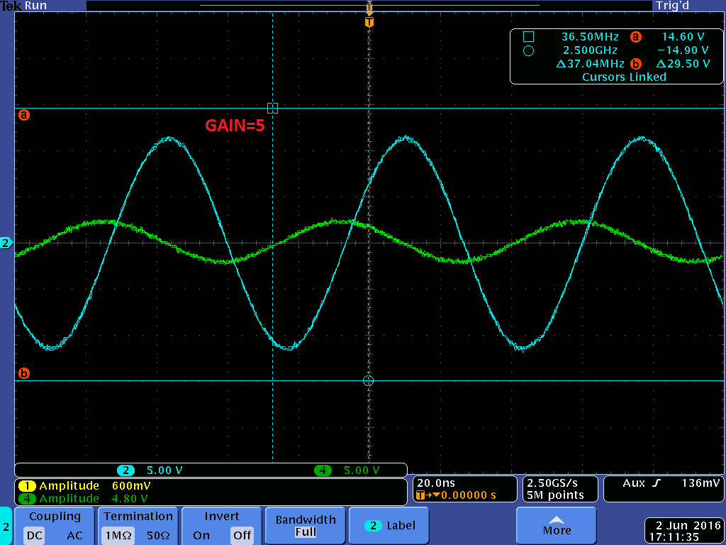

    2) I mimicked the test in the THS3091(Figure 72-75). This did work! It seems I can indeed get ~+/-12V when the circuit is configured in a GAIN=5 topology.
    Can you explain why I get better output swing at GAIN=5 as opposed to GAIN=1 @ say 15MHz?

    Do you have the ability to check the frequency response of the amplifier in unity gain configuration to see if there is any peaking in the response. When I look at your inverting operation with 1MOhm scope impedance (figure 3 in your 1st email) the amplitude seems to be closer to 24V rather than 20V. This suggests peaking in the response which can then result in slew rate limiting and other undesirable effects. On the same figure the input (green curve) seems to have < 20Vpp input. I find that behavior very strange. The buffer configuration doesn't seem to show this large amplification but does show the distortion. If you have access to a network analyzer you can look at the frequency response to see if there are any anomalies.
    For a G= 5V/V operation, there are a couple of things happening:
    1. For a current feedback amplifier, the loop-gain stability is determined by Rf + Ri*Noise Gain, where Ri is the output resistance of the input buffer. See the OPA695 datasheet, section 9.1.5 for a more detailed description. In a gain of 5 the amplifier tends to have more phase-margin which gives a better response shape. In addition to this in a G=1 configuration, Rf will interact with the input capacitance of the amplifier to produce a pole in the feedback factor (Beta) which further tends to degrade phase margin. So in G=1 operation one would think that by increasing Rf we can improve phase margin (because LG = Rf+Ri*Noise Gain), however as you increase Rf the pole formed by the input capacitance will move to a lower frequency which tends to degrade phase margin.....so you end up being caught between a rock and a hard place.
    2. Another factor that makes G=5V/V operation better is that the input buffer between the non-inverting and inverting terminal will only have to swing 4V as opposed to 20V in the G=1V/V case. This too improves amplifier performance.

    Indeed the Inverter had some gain (as the waveforms show). I was just trying to see if I could get the output swing of 20Vpkpk. After some more thought I don't think an inverting topology can be used in this application anyways (since I need High-Z input impedance to interact with sensor circuitry), so let's focus on the buffer application...
    I'll try to get a good frequency response plot of my buffer. Again it seems to work fine at lower amplitudes and/or lower frequency, so I may need to do a few different frequency sweeps.

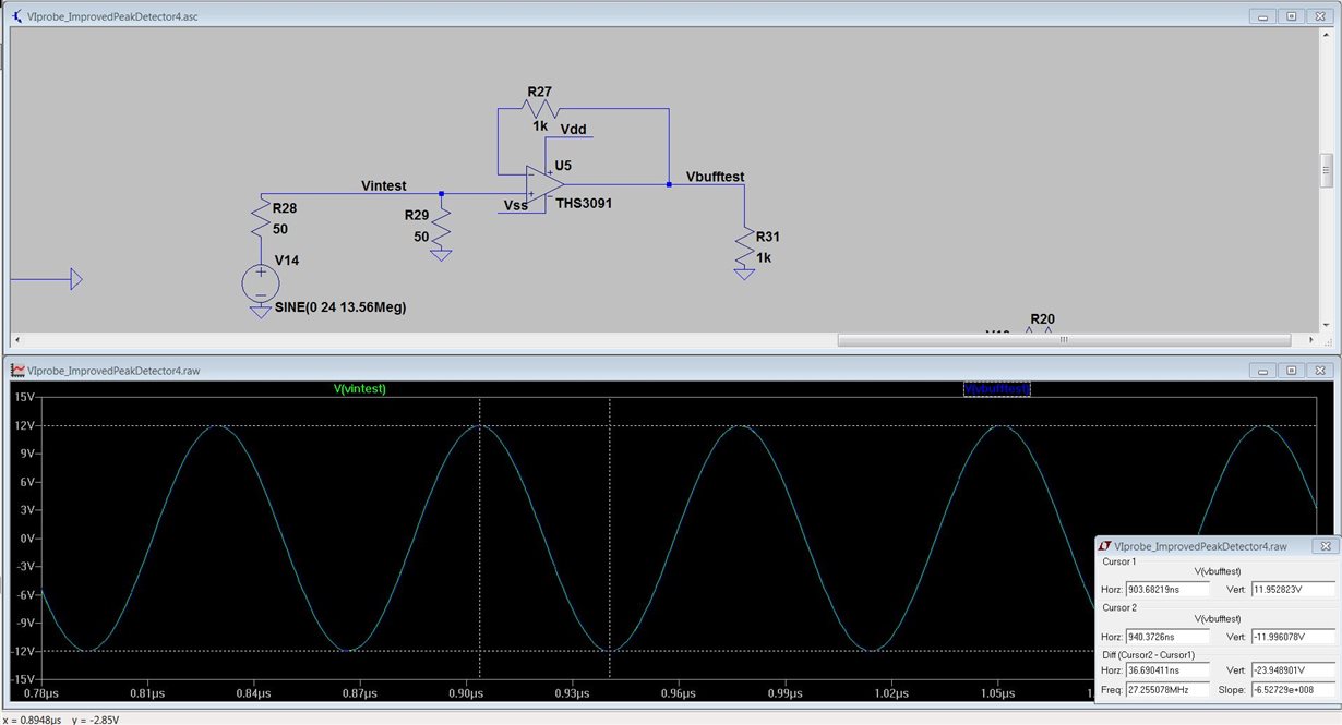

    Obviously it works perfectly in Spice (waveforms below @ 24Vpkpk), so I assume Spice model doesn't include THD.
  • Hi Ernest,
    Spice unfortunately will not simulate linearity issues. Also, this is quite an old part and the model may not be very accurate so issues like slew rate limitations on the input buffer stage may not be properly modeled. With regards to the frequency response, I suggest a small-signal response (100mVpp) and a large signal (as high as your instrument will allow you or 20Vpp). We should be able to figure things out with those two results.

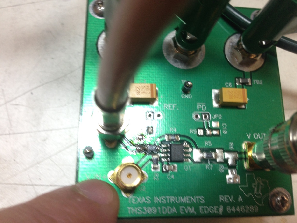

  • Hi Samir,

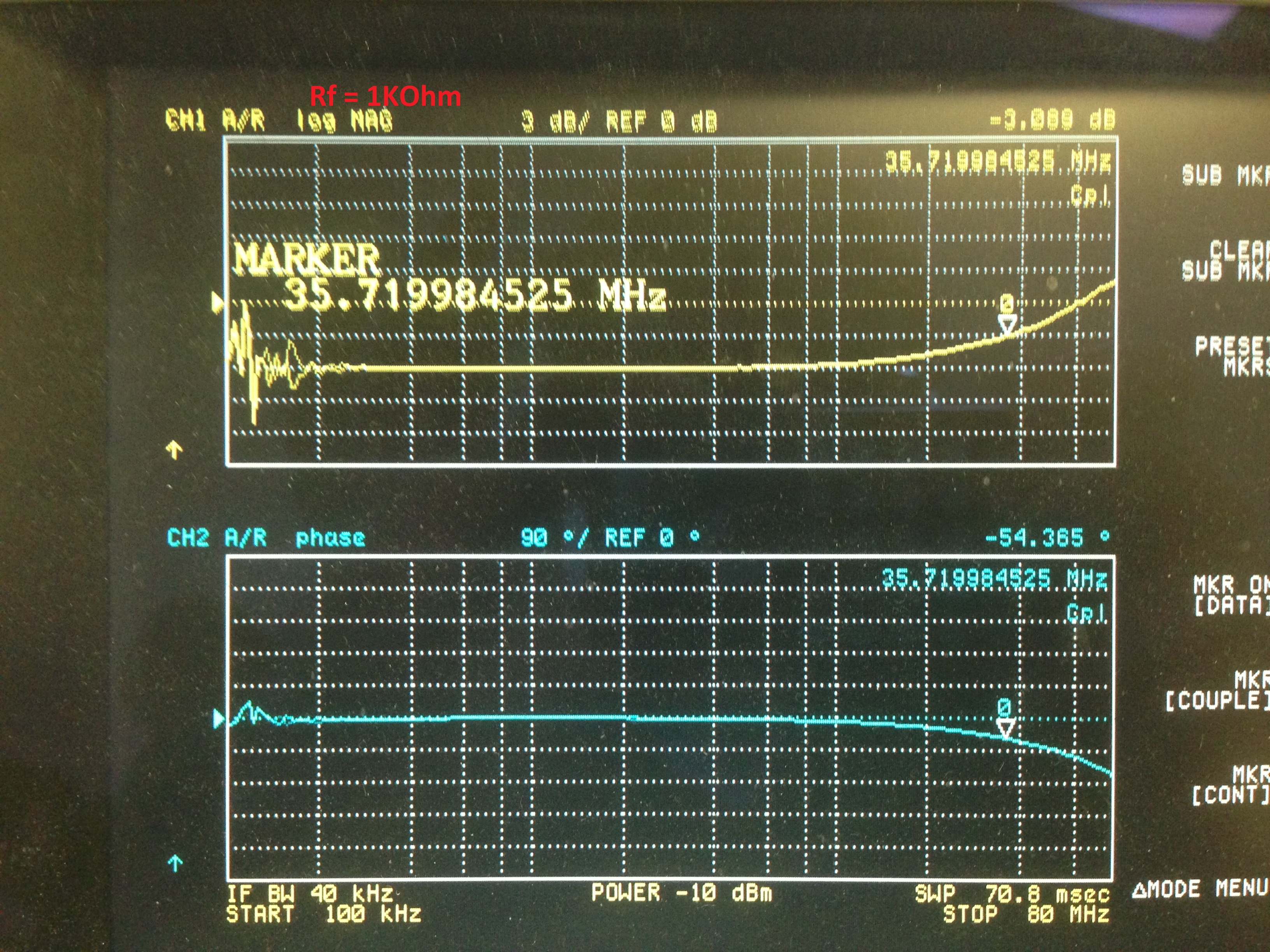

    I hooked up the THS3091 EVM to a network analyzer and did indeed see that there was some gain peaking.
    I increased Rf from 1KOhm to 1.78KOhm (from datasheet) to improve the gain peaking, and it certainly improved the gain peaking response.
    However when I look at large signal I still see the same large signal distortion. What's next?
