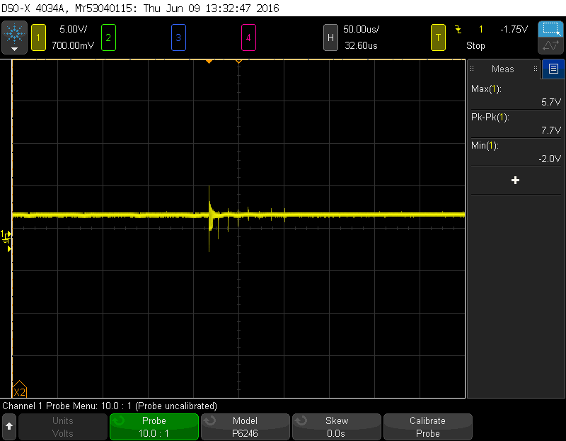

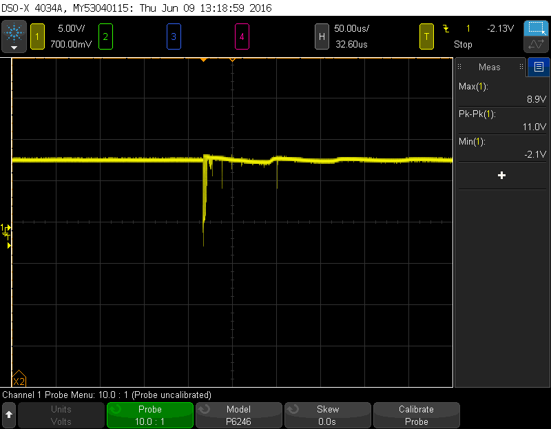

  • Here are screenshots of the voltages across each pin with respect to the comparator ground pin under typical steady state input conditions. The comparator is supplied with 8vdc. Measurements were taken with a 400Mhz differential probe at the pins where they enter the comparator casing. I cannot post schematics in a public forum like this although I could possibly email it to you.
    It should be noted that both components have failed on the "B" 5-6-7 side of the device.
