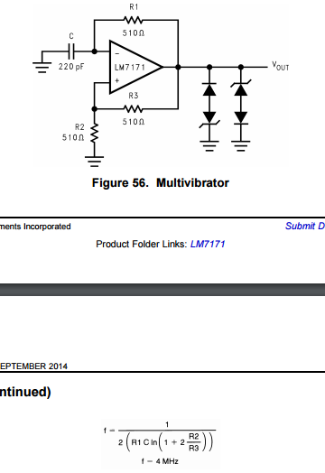

  • Thank you for your response Thomas. I am now considering a new approach. I was thinking I may generate my 40MHz or greater 3.3Vpp square wave by using an astable multivibrator similar to the one I have attached. I would need to choose appropriate circuit components based on the given formula to obtain 40MHz. I would also need to find a high speed (bandwidth atleast 500MHz), high current output (>65mA) op-amp which was capable of operating on a single supply of (V- = GND, V+ = +3.3V).
    Do you think this approach would work better? Also, are you able to suggest any such op-amp in a DIP package that can meet my needs?

    It does seem that you should be able to use a digital approach to generate a 40 MHz square wave; be it a fast multivibrator, or crystal based oscillator. Actually, the crystal based oscillator would be more precise and all of the guesswork is removed. They are available with sine, or digital output signals.
    I looked online to see what the availability of 40 MHz crystal oscillators having a digital output is from a distributor such as DigiKey. Here's the page I found online:
    www.digikey.com/.../852334
    A limitation for either approach is they don't provide the high output current level you need for your application. We don't have any op amps in our Precision Analog product line that provide the speed and current needed. However, TI's High Speed Amplifiers product line likely does. I am not too familiar with what they have to offer, but one of their Applications Engineers should surely be able to assist you in selecting the best amplifier. They have an E2E forum where you can ask pose your question:
