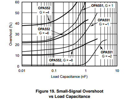

    You mentioned that the load is resistive. Do note that if any significant amount of capacitance is added from the output to ground that overshoot can occur at the edges of the waveform. This is normal. If the capacitance becomes too high the overshoot can become excessive and lead to ringing, and possibly instability. OPA551 datasheet Fig. 19 provides some helpful information. The load resistance in this case was 3 k-ohms, and the overshoot may differ some from that shown in the graph for a different load resistance. Capacitance can come about from not so obvious sources such as a cable connected to the op amp output.
    Regards, Thomas
