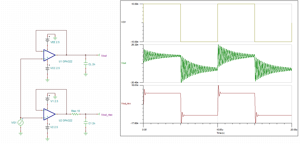

Dear all,
I would like to drive 2nF or more capacitive load with this device.
I read data sheet how to increase capacitive load.(inserting resistors)
However I could not understand how value should I insert.
Is there the way to calculate the calculate resistances?
Or..How value should I insert to increase capacitive value to 2nF at unity gain, for example?
