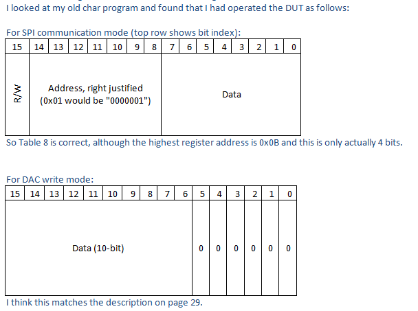

I am working on Power Line Communication with AFE031 Analog front-end Modem. I have faced problem when I was interfacing AFE031 with Tiva C series Launchpad TM4C123GH6PM through SPI. In the datasheet of AFE031, it is written that command register should have 1 R/W bit and 6 bit register address(Page no. 35 under "Serial Interface"). But then in Table 8(Command Register, Page no. 35), it is written that in command register there will be 7 bit register address and one R/W bit. Which one is correct? Please give me Read and Write transaction of SPI for Reading Registers and for DAC also.

  • Hello Rebanta,
    I was able to find and contact a TI employee who was at one time involved with the characterization of the AFE031. I sent him your inquiry and he provided me the information shown below. I hope this is what you need.

  • Thanks a lot. If any problem exists after testing I will contact you.
