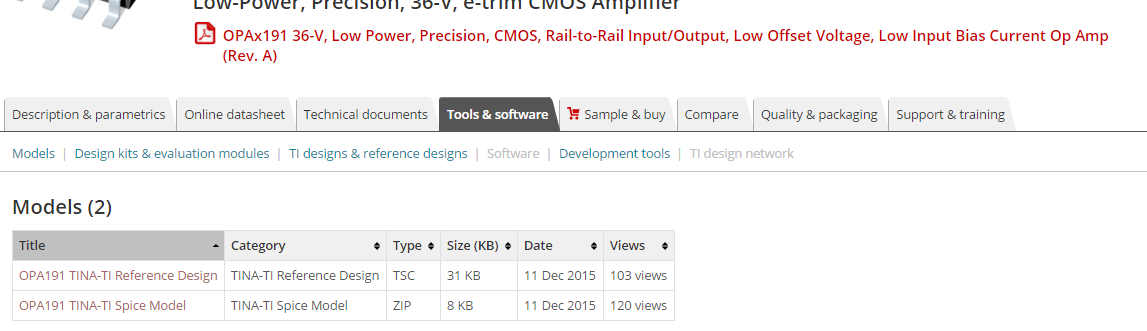

OPA191IDR orcad spice model
Other Parts Discussed in Thread: TINA-TI, OPA191, LMP2021
Can I get OPA191IDR orcad spice model.
Is it available in TI site?
  • Sunil,
    Orcad Spice model is SPICE compatible model thus it's the same as Tina-TI Spice model available on our website - see below.
    Just in case, I have attached it in this post.
    OPA191.CIR
  • I have checked with Tina-TI spice model and with the OPA191.cir just attached in post.

  • Sunil,
    I'm not an expert on Orcad simulator but contrary to your error messages all of the subcircuits are defined - see below:

    Thus the problem must be related to the way you import the OPA191 nelist into Orcad or the way you assign the pin names - they must match the following:
    .SUBCKT OPA191 +IN -IN V+ V- Vout
  • Hello Sunil,
    The "subcircuit not defined" issue is common if the netlist is imported incorrectly into a Cadence library. Please follow the steps in the attached presentation for the correct procedure to import our models into Cadence.
    Download here: PSPICE Quickstart Guide.ppt
