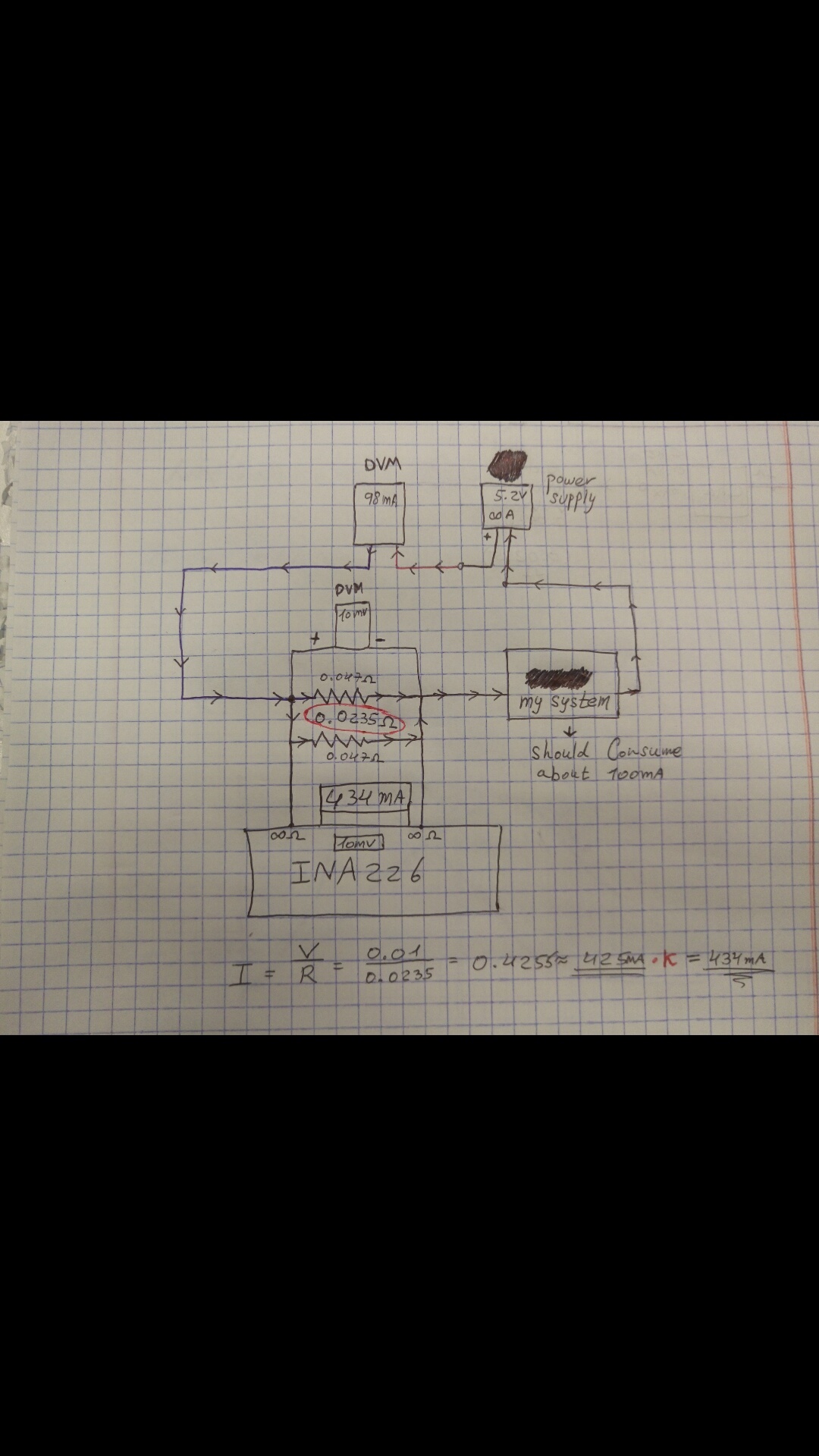

  •  I can not understand why I get totally incorrect measurement results, which is doesn't make sense at all..
    my DVM (which i trust) give me result of 98mA (really close to the actual measurement -> 100mA) VS. the INA226 module that giving me 434mA.
    again, I do know what my maximum current consumption (Through a charger chip which is 0.8A max, BQ24040 datasheet) and I set it to 0.8, Current LSB to 25uA
  • Hi Idan,
    Can you confirm the following?
    1. What is the current reported back by INA226? 434mA?
    2. The drawing shows a DVM measurement of Vshunt to be 10mV, is this correct? If so the two measurements agree and the problem is not with INA226.
    3. If both (1) and (2) are correct, you may still be suspecting that INA226 is somehow causing the large 10mV reading, then uninstall INA226, make a DVM measurement to see if the 10mV still exists. If it does, the resistance between the measurement terminals is probably not as small as you expected. This may be caused by layout, soldering etc.
    4. If only INA226 is reporting back the wrong current value, please share all relevant settings/readings, including Current LSB; CAL register(05h) value; Shunt Voltage register(01h) reading; Current register(04h) reading.
    Another note: The sense resistor you chose is too small, let alone when you put two in parallel. While this is probably not the cause of the problem and nothing prevents you from doing this, it does limit the dynamic range. An optimal resistor value is one that enablse full input range at the maximum expected current level. As an example, if the MAX expected current is 100mA, a sense resistor that is between 0.5 and 0.8 Ohm is a better choice unless the system can't tolerate a 50mV drop.
    For the same 100mA MAX expected current, I would choose current LSB to be 10uA; then with a 0.5Ohm resistor, CAL register value would be 1024 according to equation (1) in the datasheet.

  • thank you for your fast respons!!
    Well, in fact it seems that the problem is resolved.
    I disconnected the Shunt resistor (I did not mention it, but this resistors is SMD type which plugged into parallel edges of thin metal wire on each side to connect to the module) from INA226 module to perform the measurement of the resistance with my accurate test equipment (LCR), but this time I have included testing the two ends of the conductors wire i soldered before and I got a completely different outcome measurement (it was 108m ohm) relative to the resaults i have done without the wires (23.5m ohm)
    I connected the shunt to the circuit again while changing the resistor value calculation from 0.0235ohm to 0.108ohm (on the GUI) and finally got the result i was expected! (The result was close but with a deviate of 6 mA, i think it is because the resistance datasheet claim to say it is 1% accuracy and 1/10W so i get Losses.. and NO, i dont know why my parallel resistors didn't blowed up or burned)
    To be honest, I never imagined that the metal wire has almost resistance (micro ohm) but because it was thin (according to the formula R = P * L / A) 'A' was small and as a result the resistance was relatively high..
