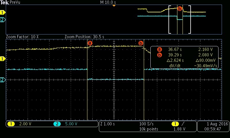

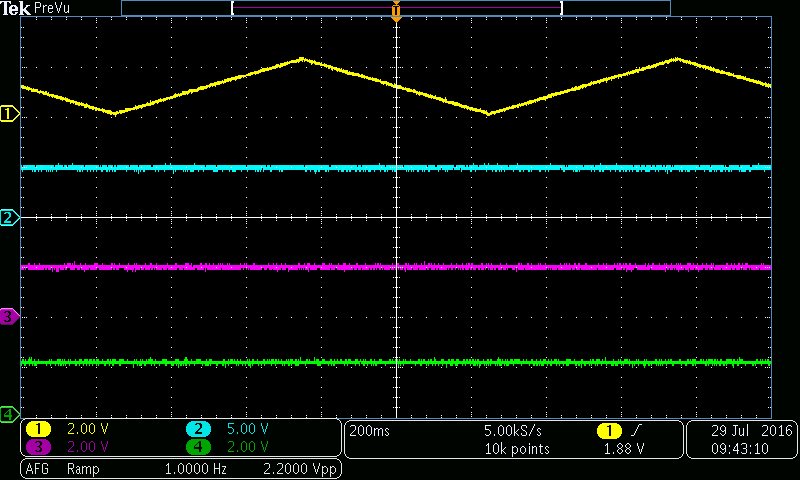

Hi ,
I encountered a problem when I used the LMP7300. As illustrated in the following Fig, LMP7300 monitors the bus voltage. I set the Positive Hysteresis is zero, while the Negative Hysteresis is Vref*R11/(R11+R17) = 122mV, which is less than max hysteresis 130mV. However, when I turn up the Vin makes the voltage of input Pin -IN is larger than Vref, the output is still in high voltage. It can not work. When I tied the Pin HYSTN to Vref, It can work well. So I'm doubtful that the key of problem is the hsysteresis setting.
Pls help me find the problem. Thx!
