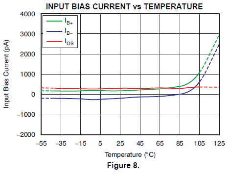

Hello Team,
does that bias current rise at 85°C represent the behavior of all OPA188?
Can you explain this rise, please?

    The input bias current graph over temperature shown in the datasheet is typical in all versions of OPAx188.  There are two distinct components to the OPAx188 input bias current:
    - The first one is caused by the current leakage of the reverse-biased ESD protection diodes.  At 25 deg C it is in few pA range BUT its magnitude roughly doubles for each 10 deg  C rise in the ambient temperature.

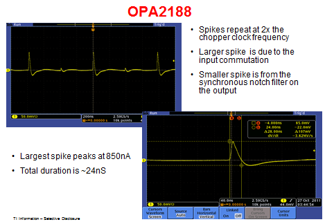

    - The second component is the integrated value of the input bias current spikes caused by the parasitic capacitance during opening and closing of the input chopping switches – see below.
    At room temperature the second component of around 160pA dominates the total input bias current while the first component becomes dominant above 85 deg C; 3pA at 25C becomes 3pA*2^6=192pA @85C causing IB rise above 85C shown in the IB vs Temperature graph and reaching 3nA at 125C (3pA*2^10=~3nA).
