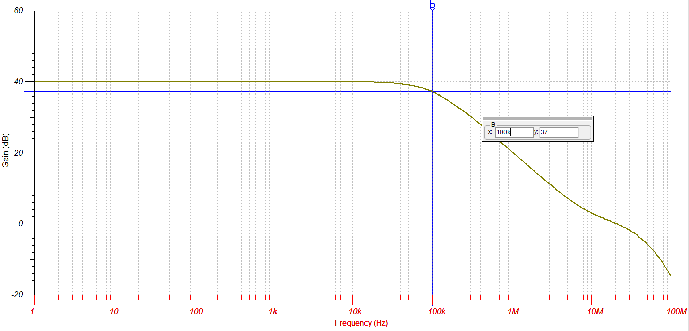

I would like to use OPA2316 with G= + 100 at f=100kHz. Please let me know what bandwidth for G= + 100 is.

The effective bandwidth is a function of the Gain-Bandwidth Product, GBP, and close-loop noise gain and thus may be easily calculated using following formula: BW=GBP/Noise_Gain. Since OPA316 GBP is 10MHz, the effective -3dB bandwidth for Gain=+100 is BW=10MHz/100=100kHz. The bandwidth may also be simulated as shown below:
