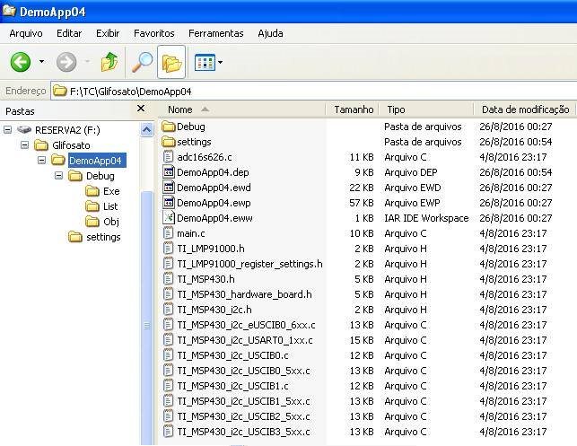

  • main.c of the demo-app04

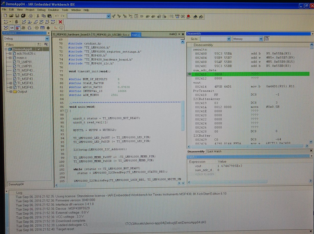

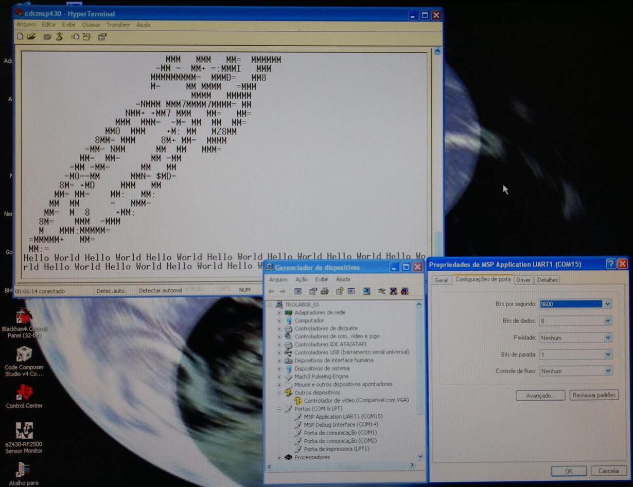

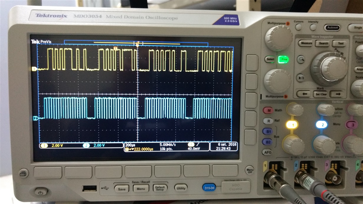

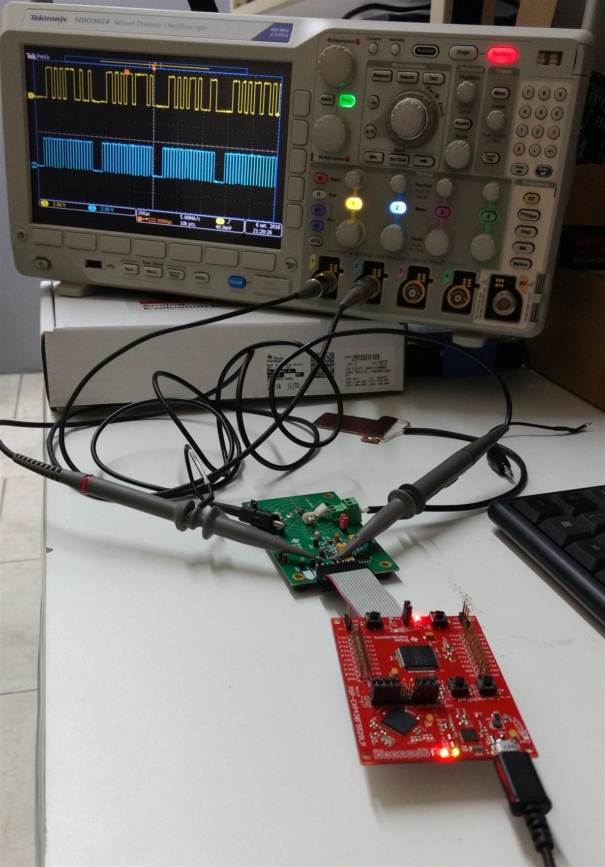

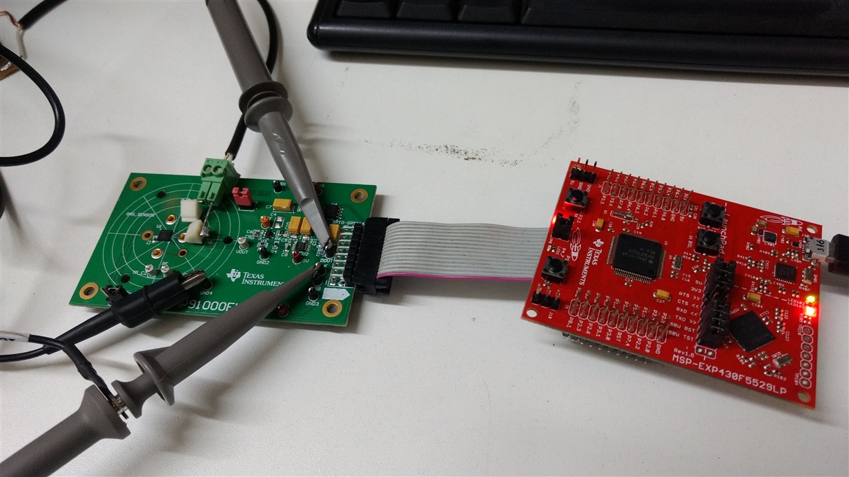

  • I decided to use the kit www.ti.com/.../msp-exp430f5529lp due to the similarity with the MSP430F5528's AN-2230.
    The pinout suggested in AN-2230 is:
    My choice was:
    Some MSP430F5528 (AN-2230) pins do not correspond exactly to the MSP430F5529 pins, then it will take some adjustments in programs for SPI and I2C connections.
    Texas Instruments offers some important documents to assist in this implementation:
    http://www.ti.com/lit/an/snaa138c/snaa138c.pdf
    http://www.ti.com/lit/ug/slau533c/slau533c.pdf
    http://www.ti.com/lit/ds/symlink/msp430f5529.pdf
    http://www.ti.com/lit/ug/snau121a/snau121a.pdf
    http://www.ti.com/lit/ds/symlink/lmp91000.pdf
    http://www.ti.com/lit/an/slaa382a/slaa382a.pdf
    http://www.ti.com/lit/an/slaa703/slaa703.pdf
    Sds,
  • To use the JTAG interface (MSP-FET430UIF) is necessary to know the content of the following:
    www.ti.com/.../slau320x.pdf
  • Reconfiguring 5-pin is required for the sample program works:
    MSP430F5528                                      MSP430F5529
    UCB0SCL - (P 3.1) - Pin 35.............. (P 4.2) - Pin 47
    UCB0SDA - (P 3.0) - Pin 34.............. (P 4.1) - Pin 46
    The GPIO - (P 2.6) - Pin 32............... (P 2.6) - Pin 35 is the same function.
    UCA1CLK - (P 4.0) - Pin 41.............. (P 4.0) - Pin 45
    UCA1SOMI - (P 4.5) - Pin 46............ (P 3.1) - Pin 38 (UCB0SOMI)

  • This is the file structure used in the program-example of the "demoapp04" (Texas Instruments) for configuration testing and output voltage measurement amplifier LMP91000.
    Sds,
  • This is the compilation of example "demoapp04" in IAR program.
    Sds,
  • It is interesting to analyze the reconfigurations needs in main.c, especially in lines 131 at 148:
    Sds,

  • Tests indicate the ultimate solution for interfacing between LMP91000EVM and MSP-EXP430F5529LP and data visualization possible through a PC:
    Sds,
  • Was made a flat-cable with pins 90° bar to the connections between the MSP-EXP430F5529LP and LMP91000EVM.
    Sds,
  • Few changes were needed in the library "TI_MSP430_hardware_board.h" and pin connections between the boards under test.
    Sds,
  • It was possible to see through a digital oscilloscope data traffic in AD converter LMP91000EVM transferred to the MSP-EXPF5529LP board.
    Sds,
  • Besides the measures of AD conversion data blocks, it was possible to visually measure the amplifier's output voltage LMP91000, properly polarized and delivering at its output an offset of 67% of "Vref", approximately 1.7 Vdc without sensor coupled in input.
    Sds,
  • The approach of tension "vout" in IAR compiler was high for the measure on the oscilloscope, with the value of 1.67447985 Vcc.

  • Finalizing the serial communication process, we have the opening of the program-example of the debug screen "Demoapp04" where you can observe the behavior of some variables and constants of the code.
  • When running the program in the IAR Compiler with "Breakpoint" applied on line 166 of the main can already be identified values of variables and constants in the "Watch 1" window.
  • When creating a serial connection using Windows XP Hyperterminal program through a serial port emulated the CDC process and settings for communication in C ++ language in the main is possible to follow the change in the value of "sum_adc_data" which presents average results of 8 AD conversions per second.
  • The values of "sum_adc_data" can be configured in Hyperterminal to present a reading by line of serial monitor on the PC.
  • The readings from the AD conversion represents the variation of the amplifier output voltage LMP91000 test and may be stored in a file type .HT to load an Excel spreadsheet, for example. Thus, it can be obtained easily behavioral graphics electrical signal proportional to the input sensor for gas detection.
