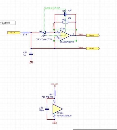

First, I would like to mention, that I have a solution for my problem. I am just writing, because I don’t understand why an oscillation with OPA365 occurs. Reading the datasheet, in my opinion the device should be stable in my circuit. I use OPA365 as in the schematic below: (Transimpedance Amplifier)

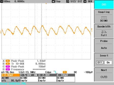

OPA365 oscillates, with kind of saw tooth @ 9MHz. See scope Plot below. Besides this oscillation the circuit works correctly.
Because of the layout I get a few additional pF feedback capacitances, what limits the rise time of the circuit to about 160ns. That corresponds more or less to a bandwidth of 5 MHz. OPA365 should have almost 90° phase margin at 5 MHz, little less at 9 MHz, so it should be stable I guess.
When I replace OPA365 with OPA354 the circuit becomes stable. Could you please explain to me, why OPA365 oscillates? I would really like to understand that for further applications. Is it possible that I see the switching of the internal charge pump at the input?
