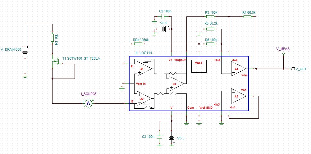

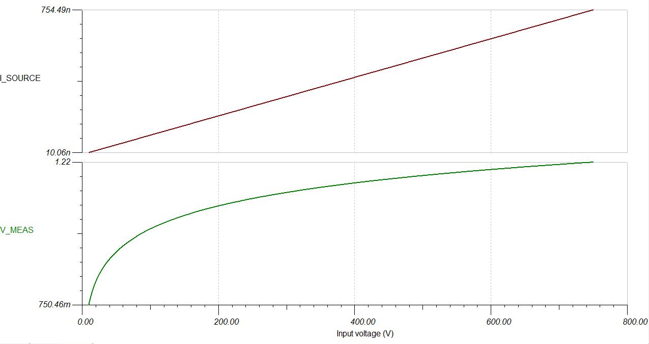

I am trying to use LOG114 to measure a small quiescent current of a power MOS. I started working using the datasheet dual-supply configuration and the simulations gave quite good results using a reference current (I1) of 10uA (VREF = 2.5V RRef = 250K).
After this I tried to build a small circuit to evaluate its "real" behaviour and I found out for current values above 2uA everything works fine but for current values lower than 2uA I get negative, "fluctuating" VOUT values:
  • I = 0,4uA - VOUT = -0,581V
  • I = 0,5uA - VOUT = -0,484V
  • I = 1uA - VOUT = -0,250V
  • I = 2uA - VOUT = 1,240V
  • I = 5uA - VOUT = 1,413V
  • I = 10uA - VOUT = 1,488V
I guess there is something to be tuned on A4 Op Amp input/feedback resistances. How can I improve the circuit to get positive stable output values on the whole range (10nA - 1mA)?

    Conceptually, I don't find anything incorrect about the way you are applying the LOG114 in the circuit.  Do keep in mind that as the input current is reduced to very low levels the log amp transimpedance gain becomes very high. When it operates with very high gain the circuit becomes more susceptible to stray circuit currents and reacts more readily to fields present where the PC board is located.
    You mention the output voltage is fluctuating. I have seen this occur when the LOG114 is receiving 50/60 Hz fields generated by the ac power lines present in the lab. The fluctuating output is evident with an oscilloscope attached to the amplifier circuit output.
    You didn't mention your circuit construction methods but the LOG114 must use PC board construction. Likely, the board will need to be mounted inside a closed metal enclosure. This will help reduce the ac fields being induced into the LOG114 PC board. The supply lines in and out of the metal box need to be properly bypassed and any signal lines in, or out, of the box should use shielded cables and connectors. Also, the PC board should be ultrasonically cleaned after any soldering operations to minimize stray leakage currents associated with residual flux contamination.
    The LOG114 is capable of amplifying very low currents and meeting the accuracy specifications in the datasheet. However, that can only be achieved when it is operated in the properly established circuit environment. If you haven't seen the LOG114 EVM information already, you may want to do so for additional information about applying the device.
