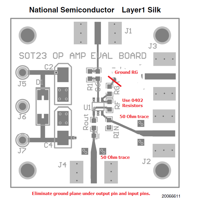

we want to use LMH6702 (SOIC) to design a signal generator, how to get the schematic and pcb files of the evaluation boards?

Hello Kerb,
I have provided some layout guidance on the attached file. If you use the SOIC package similar advice will apply. The EVM was designed to support both inverting and non inverting configurations. For best results you will want to leave out the unnecessary components and place the ground vias as close to the device as possible.
Loren
