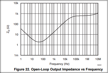

    The approach provided in the article for finding the output impedance may only be applicable to a differential output op amp because as shown in the simplified diagram of Figure 4 shows Rp being driven by Vo+, which wouldn't be present in a standard single-ended op amp circuit.
    You indicate you are interested in calculating the output impedance of a non-inverting amplifier. When contemplating op amp output impedance there are actually two output impedances to consider; the open-loop output impedance Zo, and the closed-loop output impedance Zout. The first, Zo is very important for stability analysis of an op amp circuit, while Zout is the impedance a load sees looking back into the preceding stage's output. That has other implications from a circuit performance standpoint.
    It is important to note that Zo can change dramatically with frequency and may include reactive components in addition to a resistive component (R +/- jX). Therefore, even if Zo is provided at one frequency it may not be valid at others. For this reason it is important that the op amp datasheet provide a plot of Zo vs. frequency. All new op amps from our Precision Analog Op amp group have Zo characterized and a plot is provided in the product datasheet. An example is seen in Figure 22 of the OPA171 datsheet:
    We take this one step further by including the complex Zo in our PA op amp simulation models. That allows a user to accurately assess stability questions using simulation.
