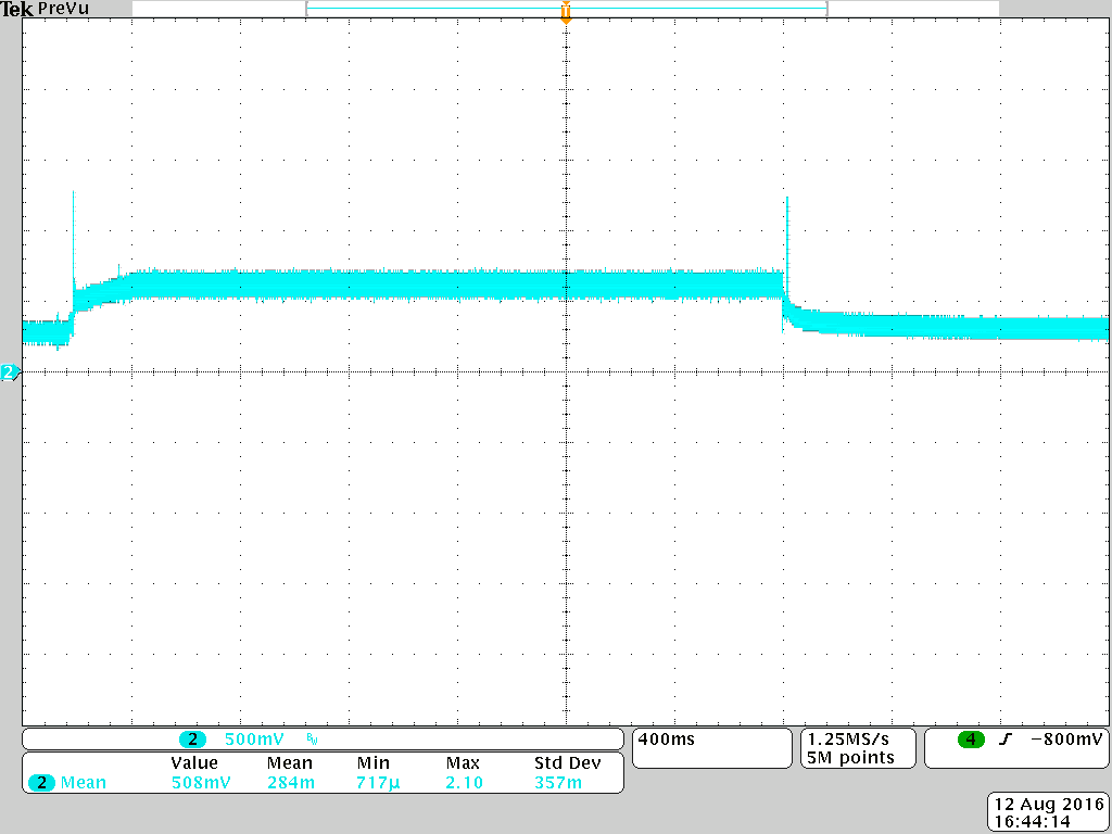

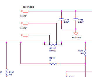

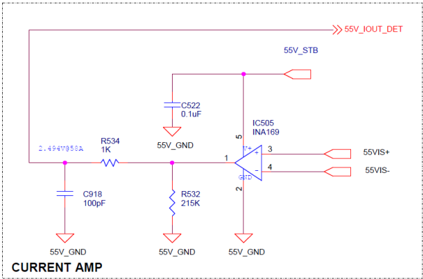

We met an issue when we use INA169 as output current amplifier, please see the following schematic. There is an abnormal phenomenon as attached waveform, when output is on or off, there is a large spike on pin1 of INA169. Could please share your comment on this issue?
Besides, currently, we used amplifier coefficient K=215:1, is it OK?
