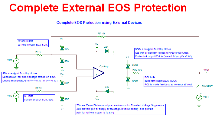

  • Jonte,

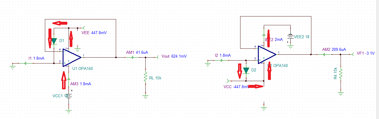

    Do you use Zener diodes or Transient Voltage Suppresors (TVS) on supply pins to assure quiescent current (IQ) path in case one supply comes on before the other?  Such protection is highly recommended for all circuits - see below.  Without it, with one supply floating even for a short time, quiescent current finds the path for the current to flow thru ESD input protection diode that can typically handle only 10mA or less.
    I simulated OPA2140 circuit using our macro-model and it shows +/-1.8mA current thru ESD input protection diodes for both, floating Vcc or floating Vee (see below), BUT the actual current might be much higher than simulation shows causing the damage to your circuit.
    You should be able to verify this by measuring the current going in or coming out of the positive input terminal - use e.g. 10 - 100ohm resistor in series with Vin+ and monitor the voltage across it with a scope during power-up.
    Below please see the recommended electrical overstress (EOS) protection scheme.
    For more detailed information about EOS, please view the series on videos under following link:
  • Thank you for the reply.
    No, I don't have any diodes in parallel with power supplies. The powers rise quite nicely in tandem though. But lets assume we have something here.
    You write that the current could be much higher than the quiescent 1,8mA. Why and how much higher?
    Do you know if OPA2140 is more sensitive to this issue than other OP amps? Since like I told, I have never ever had OP amps breaking without obvious reason (obvious for me, that is), let alone catching fire or exploding. The way I see it at the moment, there certainly is some sort of vulnerability not present in other OP amps I have used. Or a faulty batch.
