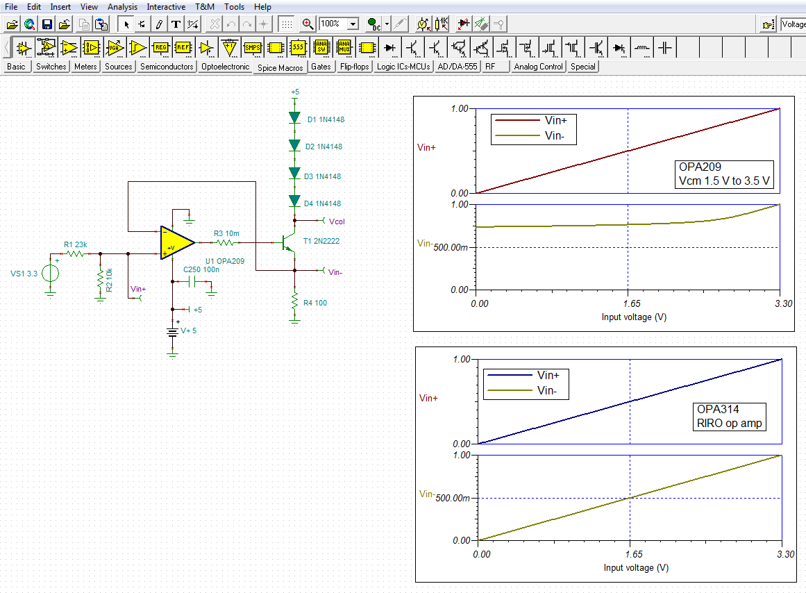

My customer is designing using OPA209A. They have concern on the OPA209A during their testing. Inverting input voltage level (IN-) in our circuit configuration below is not what we expected with the OPA209 op-amp. We expect it follows the voltage level across the non-inverting input (IN+) down to zero.
By simulation (as attached picture), OPA209A indeed behaves as it is in our testing. We tried to simulate as well another op-amp TS321, and this behavior is what we wanted.
Anything you suspect going wrong? Anything can I ask my customer for cross check?

    The issue that is occurring in your circuit is due to the common-mode voltage range (VCM) of the OPA209, which is quite different than that of the TS321. The OPA209 VCM is rated as (V-) + 1.5 V to (V+) - 1.5 V, which is +1.5 V to +3.5 V when V+ is set to +5 V. Therefore, the input voltage applied to the non-inverting input has to be within +1.5 V to +3.5 V for the OPA209 to be operated within its linear operating range. If the voltage is not within the range, then normal op amp behavior won't necessarily be observed. That is whay the inputs voltage levels are moving apart.
    The TS321 is has a VCM range rated from 0 V to (V+) - 1.5 V, which for a +5 V supply is 0 to +3.5 V. Thus, when the input is at 0 V and all the way up to +3.5 V it is operating within its linear range. Since your circuit is operating from a single, +5 V supply an op amp that is rated for rail-to-rail input, and output, would provide the widest input voltage range from a VCM standpoint.
    I ran some simulations of your circuit using the OPA209 and one of our RIRO op amps, the OPA314. The voltage at each op amp input is is measured as the input voltage source is swept from 0 to +3.3 V. You can see the differences in the input voltage levels for each the two op amps.
