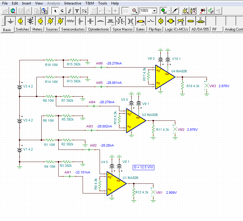

Im hoping to use 3 INA826 to measure a differential voltages over each capacitor of a total of 3 in series. I made a model of the application in TI spice and have attached it. In Tiny TI spice, the voltage on the lowest capacitor always measures about 0.07Volts lower than the cells in series above it. In the application we are finding that there seems to be a larger offset voltage and we are not sure if this is related. im trying to get an understanding of what is causing this and the best way to deal with it. Is there an internal diode or level shift occurring? I understand from the datasheet that the DC level on the Vref pin can alter the output but this dosent seem to be the case in the model.
Vref=0V (spice) |
Vref=1V (spice) |
Measured VRef=0 |
Cell1 |
1.91V |
2.91V |
1.81V |
Cell2 |
1.98V |
2.98V |
2.06V |
Cell3 |
1.98V |
2.98V |
2.06V |
