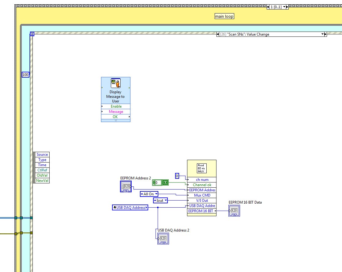

Here is what I added, I just set the EEPROM address and click a button on the front panel.
This starts the EEPROM read.

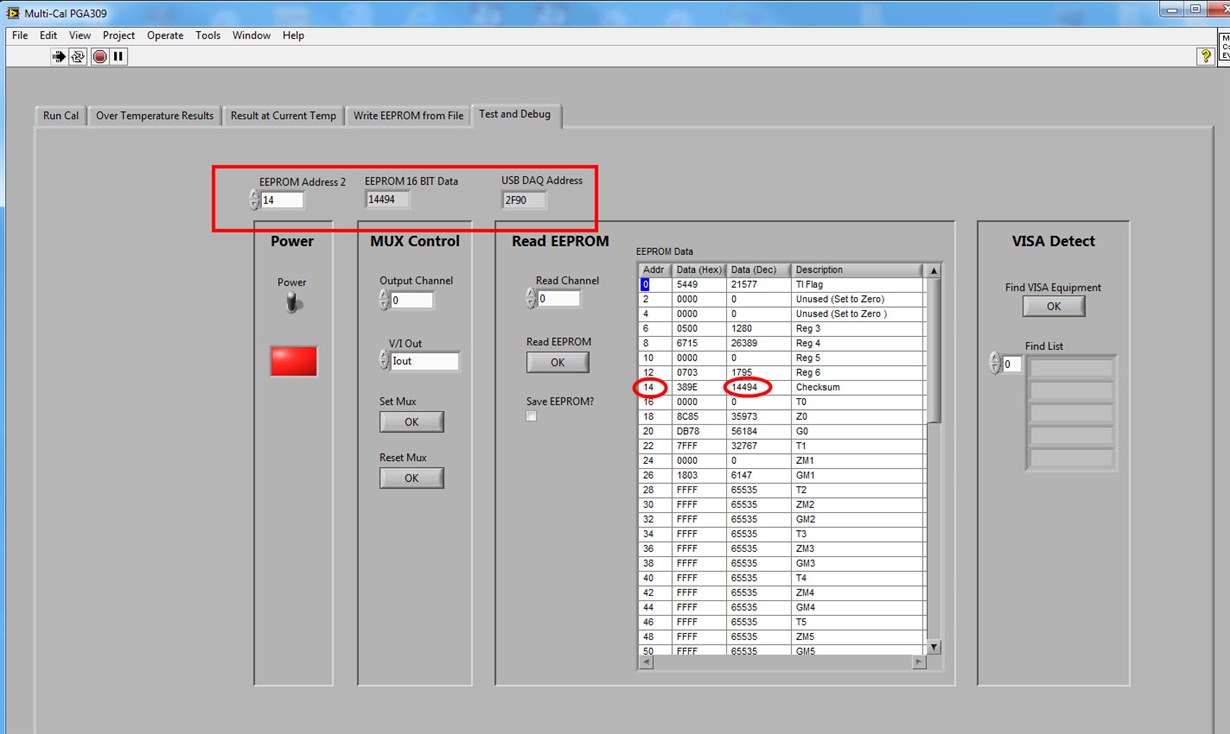

The results are displayed here. And any address in the range of 0 - 122 I can read OK.
If I have the EEPROM data output to file I also only see from 0 - 122. What ever is in the "Read EEPROM" Data table is sent to the ascii file, nothing else. Anything past 122 is blank.

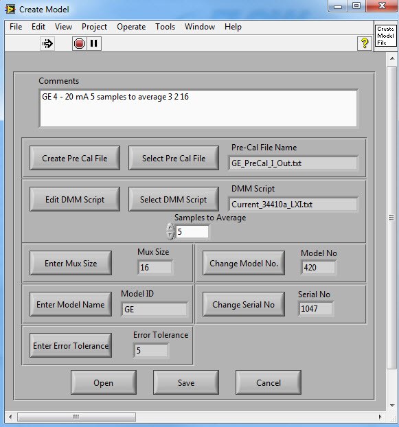

Here is my model file setup.
Any read of 140, 142, or 144 results in a 65535 value.

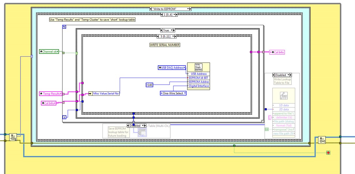

    I can verify that the Multi-Cal software does write the serial number, date code, and model number to the EEPROM addresses 140, 142, and 144. In the latest revision of the Multi-Cal software, this occurs towards the end of the "Write to EEPROM" state as shown below.
    I modified my most recent version of the software to read the full EEPROM and display it in an array, and saw that the values in these EEPROM addresses matched my settings.

  • I checked and I have the version 2.1 dated August 2014.  My version has the S/N, Date Code, Model number starting at  iteration 5 in the Write EEPROM function as I show below.
    I suspect the function is executing but not able to write to those spaces on my version.  Unless a different method is used to read those addresses 140, 142, and 144 than 0 122, then if my PCBA's EEPROM had data in those locations I should be able to read to read those spaces as I am successful reading individual address I select from 0 - 122.
    My version's screen for writing to 140 ...
    I'm using LV 2012 and I had made extensive additions to the original program.  I didn't change or add anything to the Write EEPROM section and other than not being able to read above 122 the units are programming OK otherwise.
