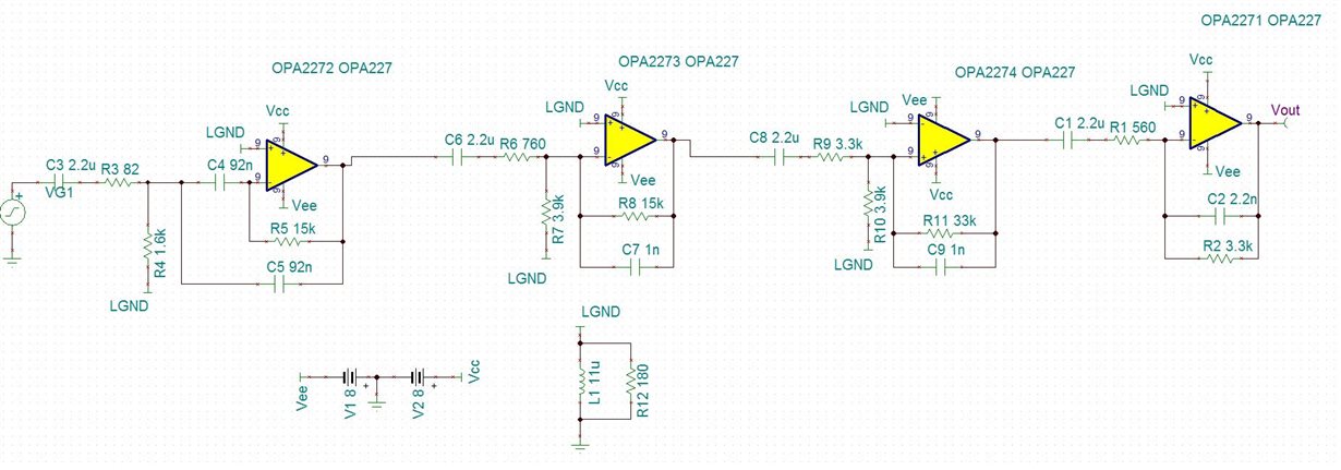

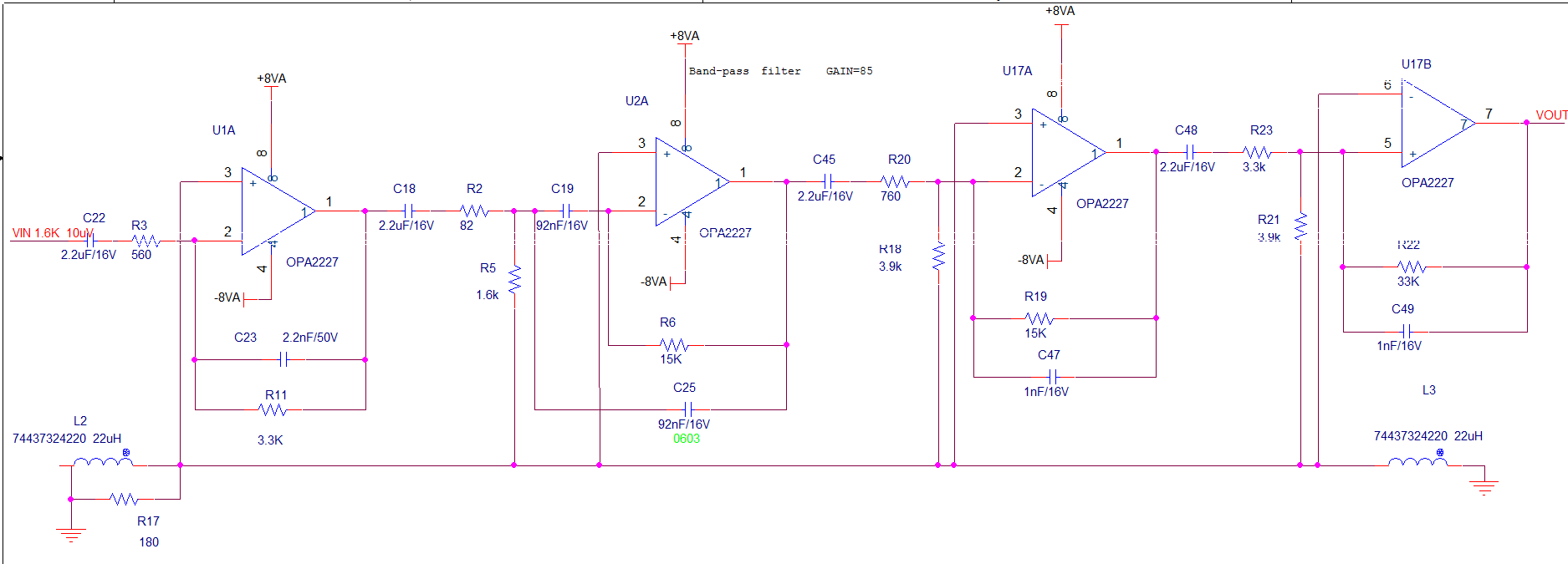

    Thank you for your guidance.I have checked the simulation frequency response of my system and make sure that my output voltage at 1.6kHz is around 100dB. Also, I make sure there  is no issue with the equipment used,measuring the output or supply voltage.My schematic  is as follow.
    I did not account for the noise gain of the overall circuit accurately.While,to reduce the effects of noise on the output,I put the second-level designed as a band-pass filter.The center frequency is 1.6KHz,and 3-db bandwidth is 200HZ.
    The distortion present at the stage 3,and it is worse at stage 4.
    Could you make sure the reason after reviewing the schematic and the video?
    Is there any way possible to result the question?
    Bingtong

    After reviewing your schematic and your changes, I notice there are a few more things to further reduce noise in your circuit. However, I think that it is important to point out that a 100µV (or 10µV like it says on your schematic) is comparable in magnitude to the noise that you will see in your circuit.

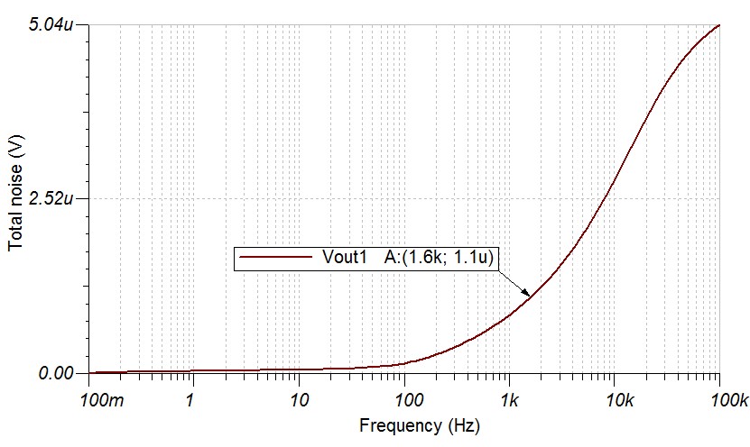

    Using TINA-TI a SPICE simulation software I was able to simulate your circuit and obtain the total noise and the voltage noise density curves. The first stage of your circuit alone with contribute 1.1µVrms at 1.6kHz like shown in the figure below.
    As a result, the noise will be coupled into the signal, gained up throughout every stage, and eventually corrupt the output. After looking at the video I am surprised that the problem is not worse.
    However, I do have some more suggestions for you to help you in your endeavor. I noticed that all of your gain stages are almost equal in magnitude. Traditionally it is better to put the higher gain stages first so the noise of subsequent stages contributes less to the output.

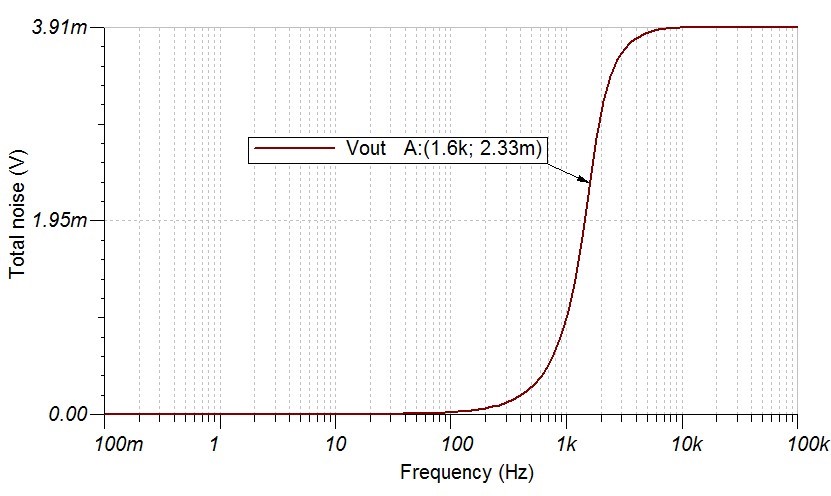

    For example, the figure below shows the total noise at 1.6kHz for your current circuit configuration.

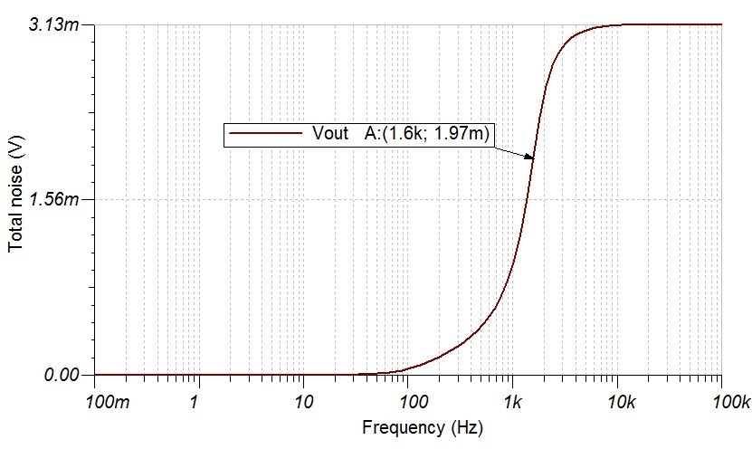

    Taking note of the 2.33mVrms voltage-noise, I then arranged your circuit so the higher gain stages are first and obtained 1.97mVrms voltage-noise shown below.
    To build on this topic, you should try to put as much gain as possible in the first couple stages. I notice that your highest gain stage is 25.8dB which equates to 19.5V/V. If the OPA227 GBW product is 8MHz this means your effective BW is 410.3kHz when you realistically should have at least 1 decade above your frequency of interest (feel free to be more aggressive if necessary).
    In summary, I encourage you to front load your gain on the beginning stages and increase the gain on those stages. Amplifying signals this small will always have noise problems, but you can minimize those problems with these techniques.

    I notice that you have resistors and inductors connected to ground in your simulation. I assume this is to model the trace inductance and impedance of PCB layout because they do nothing for your circuit otherwise.
    I also see that your last stage is using the noninverting pin for feedback; I would double check if this was intended.
    It seems like this schematic is bigger than what you showed me—which is fine. I would like to encourage you to look into decoupling capacitors near the positive and negative supply pins of the op amps to help reduce transient problems you may have.
