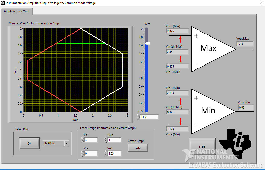

I use INA826 to convert an audio signal diff to single. Vs = 3.3V and Vicm = 1.65V and Vref = 1.65V G = 1
in datasheet, it is said the Vicm max in V+ - 1V.
In the datasheet, figure 9,  the Vicm seems to be over limited when Vs = 3V (Vicm max is 1.5V)
==> I understand my design should not work.
I test my case with TINA ans it works.
Am I wrong or Tina is wrong ?
