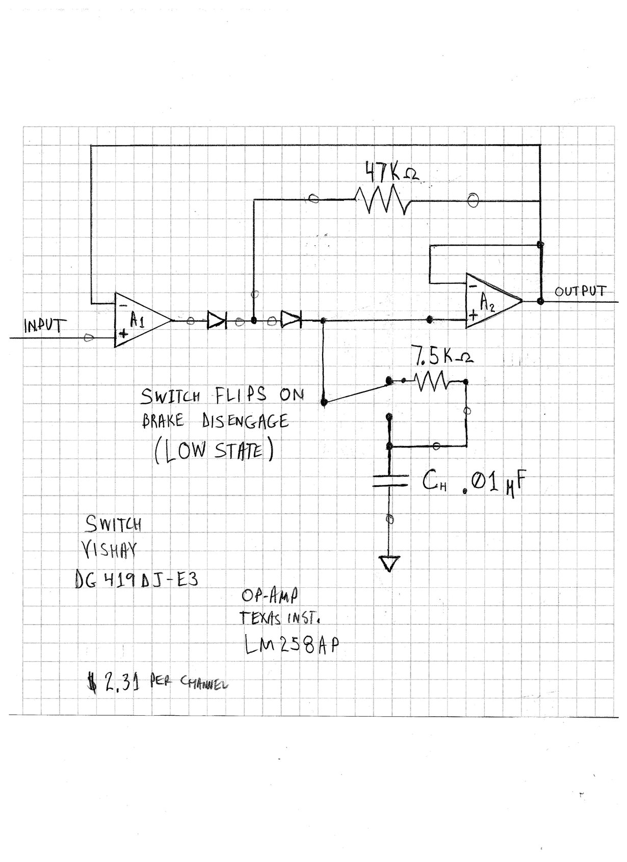

  • Hello Paul, Thank you for the assistance with the peak detector circuit. I ended up using a Texas Instrument LM258AP OpAmp. I scanned in the schematic for you to get a good chuckle. I am using an analog switch in the circuit because I want the output voltage to follow the input voltage when the circuit is not in peak collect mode. I also wanted the capacitor voltage in relatively the same neighborhood when the peak voltage acquisition window is initiated. Thanks again for your help.
  • Hi Steve,
    Hmmm...I'm note sure it will do what you want.
    Flipping the switch really does nothing...other than limiting the current into the cap. The cap is not big enough to hold the voltage against the amplifier output, thus the "peak holding" will still continue, even with the switch flipped to 'hold" mode.
    Instead, I would recommend replacing the right-hand diode with the CMOS switch, so that it completely disconnects the cap from the driving amp.
    In short - duplicate the ADI circuit (though the ADI circuit uses a current to charge the cap...so it is a little more sophisticated).
    You are also missing a diode and feedback resistor clamp around the first amplifier which keeps the output of the amp from railing on the negative side. See the following example below (ignore the 30pF cap -  that is specific to the LM101 - and any op-amp can be used).
    You also want to increase the 47K resistor to 1M, as this resistor bleeds a little current into the diode to cancel the leakage. R2 is a bias cancelling resistor - not needed if you use a JFET or CMOS input device (see below).
    So you would put the switch between D2 and C2.
    The problem you will run into is that during hold, the first amplifier goes open loop when you "hold", since the outer loop feedback is broken. That means the first amp output will rail. When you go back to tracking, there will be an initial "glitch" and recovery time as the loop re-stabilizes. D3 above will clamp the first amp output to ~300-700mV of Vin (reduce R2 to 100k or so to prevent too much current through D3). So the output would only move <800mV, instead of volts.
    Probably the simplest way that eliminates overdrive, glitches and settling issues, is to use a third buffer amp and disconnect the cap completely from the circuit, then just buffer the resulting voltage on the cap. Then the peak loops continue in-tact and are immediately ready for the next cycle.
    Either way, you need a way to reset (short) the cap - otherwise it will (theoretically) stay at the highest peak received over the entire time (minus leakage droop). There should also be at least 200 ohms in series with the cap to prevent the amplifier from oscillating - preferably before the switch (switch input capacitance can also cause oscillations).
    This circuit begs to be simulated...I recommend you try a few simulations to make sure the circuit is working as you think...in both track and hold modes.

  • Hello again Paul, The "diode and feedback resistor" schematic did not come through. It showed up as a black "x". I think I have seen what you are talking about on a couple of the images that I saw when searching the Internet for peak hold circuits. Getting back to my original schematic... The 7.5K Ohm resistor is to keep the charge of the hold capacitor in the relative range of the input voltage just prior to a peak hold cycle. The issue is, the machine may be at rest for a couple hours before being used for 6 hours. The input voltage is permitted to drift around until it's time to perform a peak hold cycle. The peak hold window is open for about 2 seconds. The whole issue is the input voltage changes at 6000 Hz. The data acquisition can only process and look for a peak at about 100 Hz. Your comments are more than welcome. Thanks again for your time. SFR
