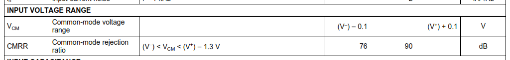

Fig. 23 of the OPA2376 data sheet indicates that V,os begins to degrade as V,cm -> 0V.
The data sheet spec's V,os for V,cm = Vs/2.
How much degradation of V,os can we expect when V,cm -> 0V?
Thanks, Best, S. Dunbar, AFA Colorado

    The change in offset voltage vs. common-mode is most prevalent in the upper common-mode voltages where the NPN input stage takes over to prevent phase margin and allow for a functional rail-to-rail input stage.  The common-mode rejection ratio defines the change in offset voltage vs. common-mode voltage and is valid over the region in question near V-.  Therefore the worst-case change in input offset voltage vs. VCM near the V- supply is 76dB or roughly 158uV/V.
  • Collin-
    Understood about the V,OS at the upper end. We are specifically looking at the lower end.
    We would not think to apply CMRR to this otherwise DC precision offset parameter.
    If V,CM = 0V, then what is the degradation in V,OS? I'm not sure how to apply the 158 uV/V here.
    Thanks, Best, steve

  • Thinking about this a little more using CMRR, if we go from V,CM = 2.5V down to V,CM = 0.0V, that's a shift of 2.5V.
    According to your analysis, V,OS must be degrading 2.5V * 158 uV/V ~= 400 uV.
    This would be far more than what is actually shown in Figure 23, no?
  • Hi Steve,
    Your calculations are correct for translating VCM shift to Vos shift using the CMRR specification. 2.5V * 158uV/V = 395uV. Keep in mind that all datasheet plots represent the typical behavior unless otherwise noted. Therefore Figure 23 was based on the typical specification of 90dB or 31.5uV/V, which would result in only 79uV of shift when moving from a Vcm of 2.5V to 0V with a 0-5V supply.

  • I need to worst case stack up of non ideal behavior to insure my design works across all devices and temperature.
    From above, Vos (25*C) is 25 uV. Shifted for temperature, gives 25 + 2uV/*C x (70-25) = 115 uV.
    Then I adjust for Vcm shifting (worst case), which is 158 uV/V, shifting additional 396 uV.
    Worst case Vos = 115 uV + 396 uV = 511 uV, correct?
    Similarly, for Ibias, starting at worst case of 10 @ 25*C, shifting to 75 *C = 10 x 2^5 = 320 pA, correct?
    Tim
  • Hi Tim,
    The calculations for the maximum bias current are correct.  Your calculation steps for the offset voltage are correct, but you should use the 1uV/C specification for temperatures under 85C (see spec table below). So the maximum Vos due to temperature at 75C is 25uV + 50C * 1uV/C = 75uV, yielding an absolute worst-case situation of 471uV.
    That said, both of these conditions are unlikely to occur in a production system.  Devices with a single maximum specification are already on the far edges of the Gaussian distribution, making them rare.  A device that would display all of the maximum specifications is nearly statistically impossible.  This is because most maximum specifications represent at least a +/-3sigma distribution (99.7%), meaning only 0.3% of the entire population of produced devices have one specification at or above the maximum limit.  Devices outside the maximum limit are discarded.  Combining even two maximum specifications results in a +/-6 sigma type device or 1 in 500 million units.  Combining more maximum specifications results in an even more unlikely device.
    So, while your results do predict the absolute worst scenario you could encounter using this device, the chances of you receiving such a device are very small.  Often specifications are combined using an RSS (root of the sum of squares) method to produce more probable results.
