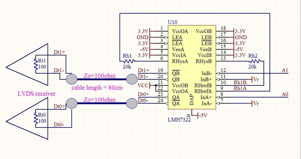

Dear Sirs
LMH7322 output to LVDS receiver
Signal input from A0 & A1, compare to Vr.
Reference circuit from LMH7322 data sheet Fig.24
But change the Vcci from 5V to 3.3V, Vcco from 2.5V to 3.3V.
Is the schematic ok?

Hi Nat,
I don't normally work with comparators. I think this would be better posted in the General Purpose Amplifiers & Other Linear section. The High Speed Interface forum also covers LVDS devices.
I will give you my best answer, though. On page 2 of the datasheet is shows a supply voltage range of 2.7V to 12V (Vccx - Vee), so your supply voltage levels are fine as far as device operation is concerned.
If you look at Figure 24 it shows +5V for Vcci (comparator supply) and 2.5V for the Vcco (output reference) and then a -5V Vee.
If you change Vcco to 3.3V your output levels will now be 2.2V and 1.8V. This is not LVDS compliant anymore. So I think this will not be a good idea.
The other thing I noticed is that your A1 will be opposite polairty to your A0. Was this intentional?
