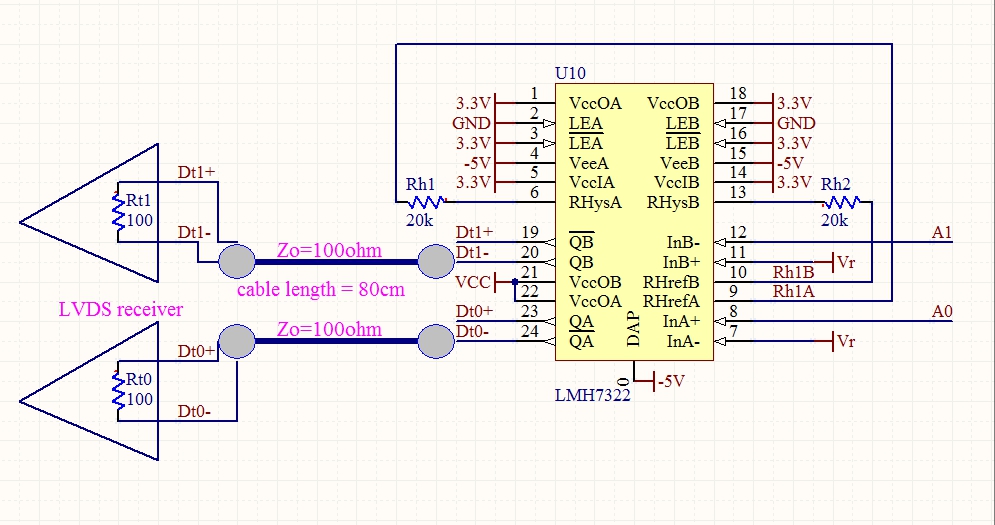

Urgent: LMH7322 output to LVDS receiver
Dear Sirs
Signal input from A0 & A1, compare to Vr.
Reference circuit from LMH7322 data sheet Fig.24
But change the Vcci from 5V to 3.3V, Vcco from 2.5V to 3.3V.
Is the schematic ok?
