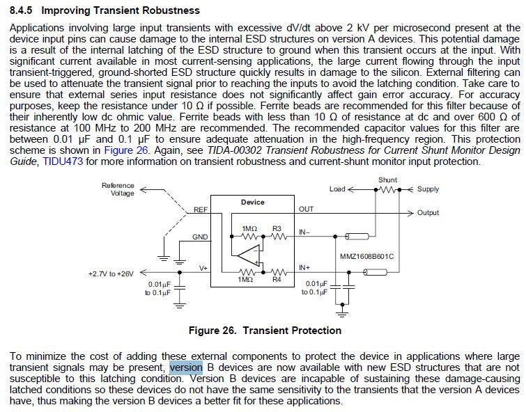

    In all the cases of failure you are quantifying, are you seeing the part rail to Vsupply? Or in some cases is the measurement just outside the scope of measurable tolerance? We need to know what you are constituting as a fail, as you mention removal of the filter resistors lowered the percentage of faulty operation. Could you clarify this? As you are using the A3 version of the part (200 V/V gain), you only have a Vsense window of 25mV operating with a supply voltage of 5V before the device will rail to the output. If Vsense >25mV, a saturated output is to be expected. Also, what common mode are you operating at for the device in each design?
    Is it possible to isolate the device on one of the boards and inject an input signal to see if you get the expected output on the other side?
    It isn't recommended to use PCB trace as the shunt resistor, as there are too many possible factors that introduce error into the circuit. Trace tolerances in three dimensions, uniformity of copper in the trace, copper density, all of these can lead to errors that may alter the measured resistance of the shunt, and those errors will then be amplified by a factor of 200.
    Finally, which version of the part are you running? As you are on the high side, depending on the nature of the transients from your power supply when it is switched on, it has the capability to cause damage to the parts. If you look at the excerpt from the datasheet below, you can find the metrics for where version B should be utilized.
