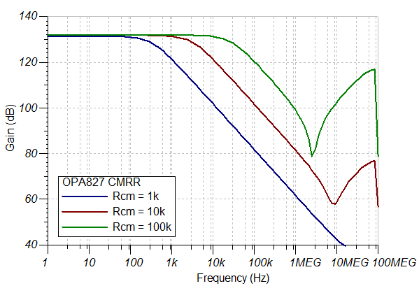

I'm trying to do some sims of CMRR of the OPA827 on Tina-TI. Below is the topology that I'm using to test the CMRR of the SPICE model:
I first do a sim with all R's set to 10K. Looks nice, pretty close to datasheet:
Then, I change all R's to 100K. Looks like this:
I was not expecting such a drastic change. The BW is much different using 100k's instead of 10k's.
Is that right? Or, could there be something wrong with the model?
If anything, I would have thought that changing from 10k's to 100k's would make things worse. I'm thinking that because the larger R could create a bigger V difference because of input currents. Or, if anything, I would think that larger R's would make the BW worse if there is any input capacitance in the model. Regardless, I can't think of many practical situations where larger R's result in wider BW.
Thoughts? Does this make sense? Something wrong with the model?
