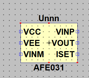

  • hello ,
     I am trying to use the PSpice model of AFE031 but can't figure out the functionality of pins , can you help me with what each pin does.
    i've generated this symbol from Pspice model by importing it into LTspice and using automatic symbol generation.
    Thank You
