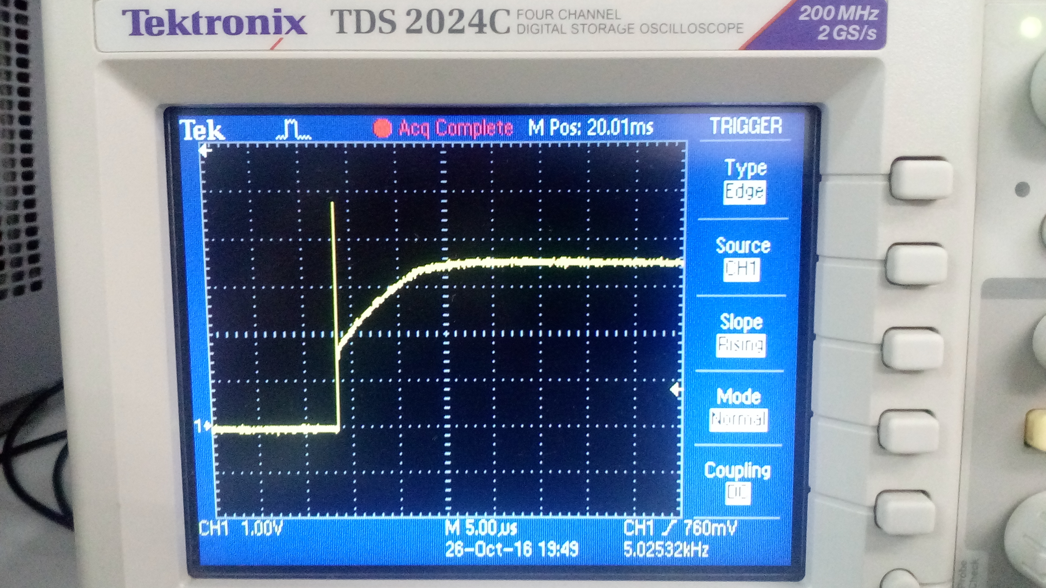

The problem is as follows: The output rings as the switch transistions from ground to analog voltage. Following is the oscilloscope screenshot
The output has to transition from 0 to ~3.5V when this happens. Further, the ringing does not end in the output settling to 3.5V there is some sort of capacitor charging behavior following up.
Following is the screenshot (zoomed out and a larger time frame)
The above measurements are with no-load at the output of the opamp.

            The ringing problem has been solved (in a certain sense). The ringing was being caused due to the oscilloscope probe. Adding a series resistor around 5K (to the tip of the oscilloscope probe) stopped the ringing completely (but also made the rising edge less sharp).
    However the ~10us capacitive charge like waveform in the transition from zero to high voltage still persists. Please advise.
    The slew rate of the opamp used is 560V/us so that should not be the cause.

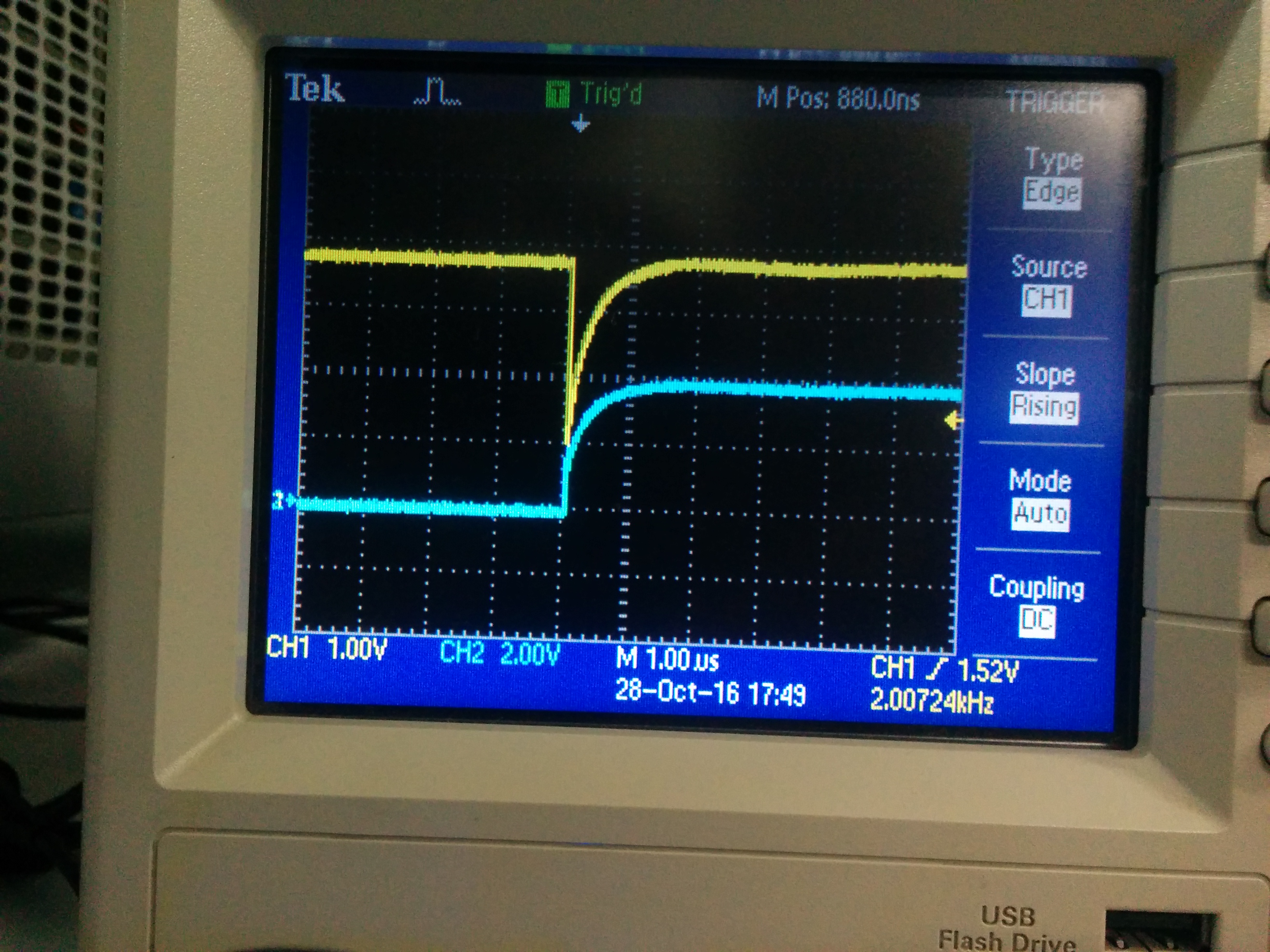

    The yellow waveform is the input at the NO port and the blue waveform is at COM (note the difference in voltage scales).
    We also tried the alternate approach of using the trimpot to feed the voltage at the NO port (please refer to the schematic). The behavior is same but the delay is much less now. Following is a picture of the waveforms,
    Looking forward to your input,
    SM
  • SM,
    The wave forms look good from a switch perspective.  The switch is passing the input to the output with no distortion.  We will need to look elsewhere in the circuit for your extra loading. It appears the when you switch to the NO path that your power supply is getting loaded and cant immediately drive the input to the op amp.  I'm going to move this thread to the op amp forum for more assistance on that part of your circuit.

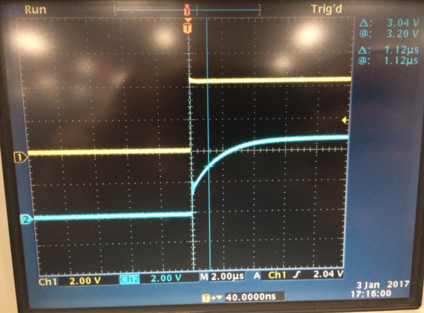

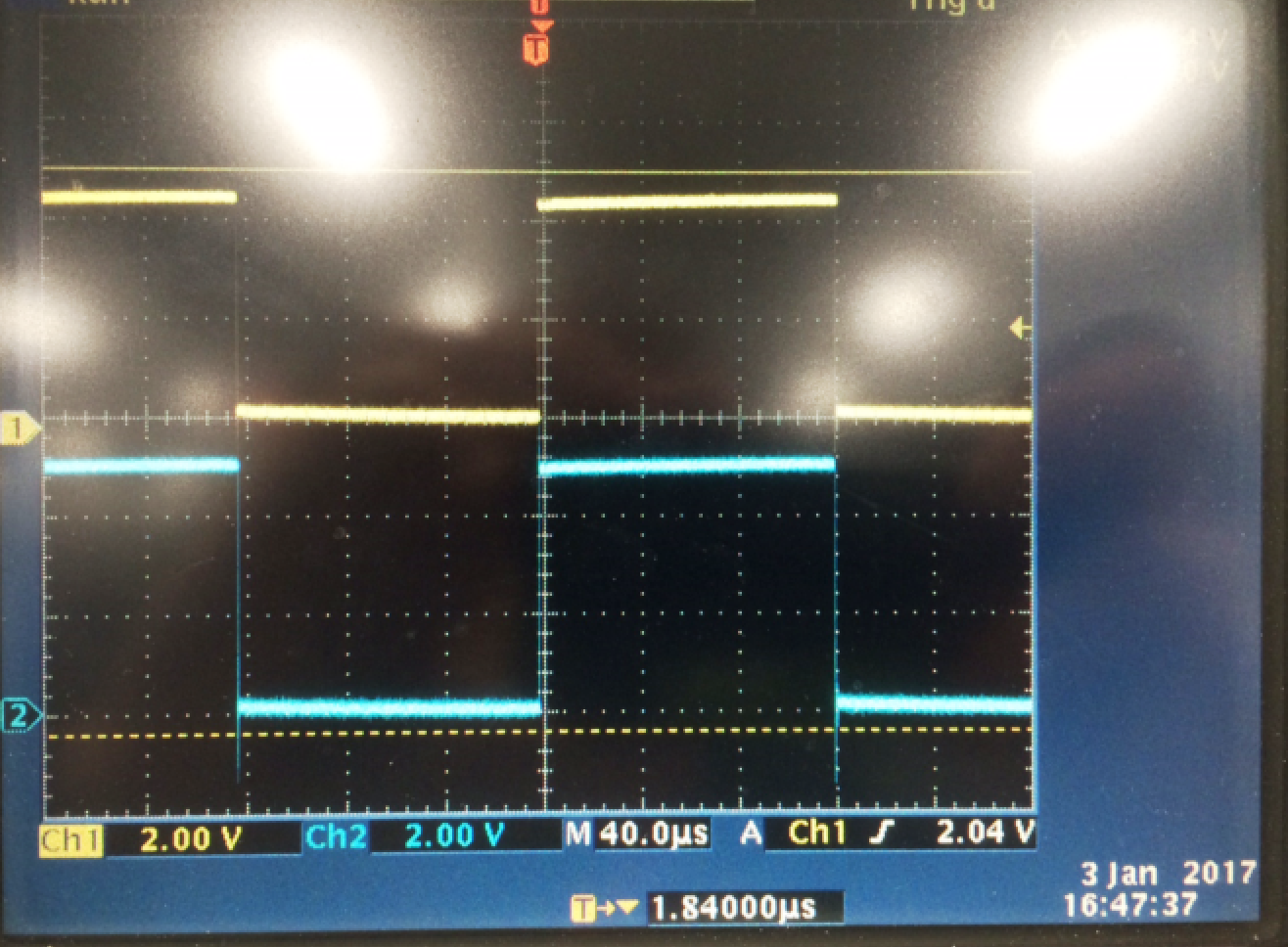

    I have been able to duplicate your delay in the lab using only the TS5A23159 configured the way you have it in your schematic using a 20k ohm resistor for your potentiometer.   The yellow wave form is the IN1 signal and the blue waveform is the COM1 pin.
    I removed the 20k ohm resistor between the 5V supply and pin2 NO1 and saw no delay
    This lead me to think that there is an RC delay created with resistor and the TS5A23159 On-state capacitance.  The on-state capacitance of the TS3A23159 is ~56pF.  With the 20k ohm resistor I would expect to see a ~1.12us delay for node to reach 3.15V which is what I measured below.
    To reduce this delay you could use a lower resistance or a different switch with lower on-state capacitance so it doesn't take as long to charge up the node when the signal path is selected.  On the TI.com switch selection tool you can filter some devices on their on state capacitance spec.
    I'm sorry for the delay on responding to this.  Let me know if this helps.

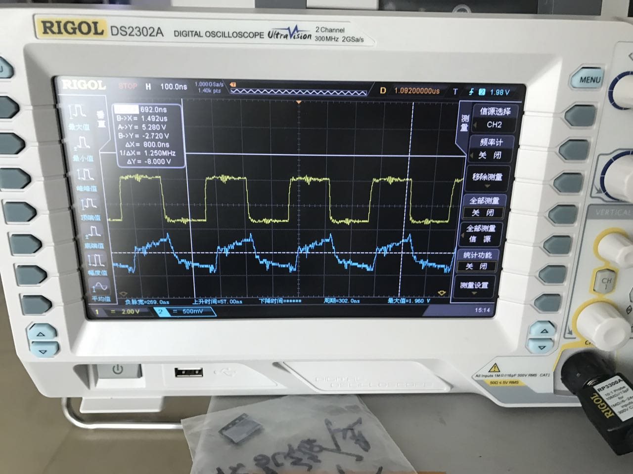

    I want to know whether TS5A23159 can be applied the case that the switch frequency is 5MHz ?
    I found the output of the chip  appeared signal distortion under such high switch speed.
    The yellow waveform is the IN1 (Pin 1), the blue  waveform is the NC (through 400Ω to ground). And the COM is connected to 2VDC.
    Looking forward to your reply, thank you.
    Debao Wei

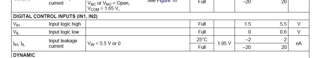

    The yellow signal into pin 1 (IN) needs to be larger voltage amplitude inorder to cross the valid logic high threshold (Vih).  Based on your scale in the scope shot of 200mV it looks like your signal is only going up to 400mV which is not enough to make the IC switch the COM pin from the NC path to the NO path.  If your Vcc is 1.95 V you need at least 1.5 V on the IN pin to switch the COM pin from NC to NO.
    What you are seeing in the blue wave form is likely the parasitic feedthrough from IN pin.

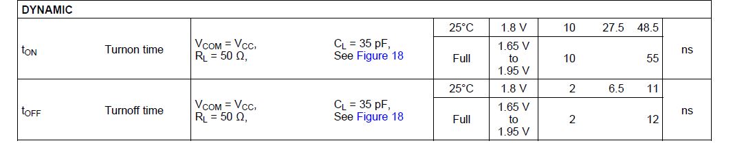

    We don't specifically spec the max switching frequency but we have the Ton and Toff times which can give you an idea how fast you can toggle between the channels.   The TS5A23159 should be able to handle ~10 MHz.

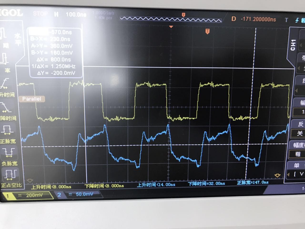

    In fact, the voltage amplitude of yellow signal into pin 1 (IN)  is large enough, because the voltage has a X10 attenuation when we use a oscilloscope probe.
    The following figure is the right waveform. So I still want to know whether the poor signal quality of IN bring the signal distortion of NC.
    Thank you.

    Would you be able to show the IN pin (1), NC 1 pin (9), COM1 pin (10), and NO1 pin (2) on one screen?
    Something is not correct based on your description above and the scope shot.  Below is a picture of how I understand your circuit and the expected waveform relationship between IN1 and NC1.  When the IN1 pin is low that COM pin 2V should be present on the NC1 pin.  When the IN1 pin is high the NC1 pin should be pulled down to ground.  The waveforms you are showing are the opposite.  Would you please help confirm my understanding of your circuit?
