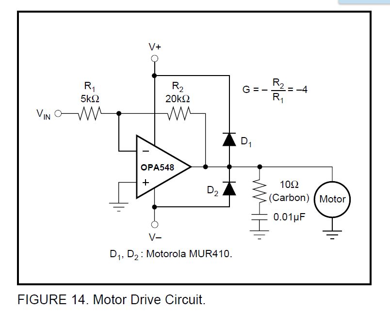

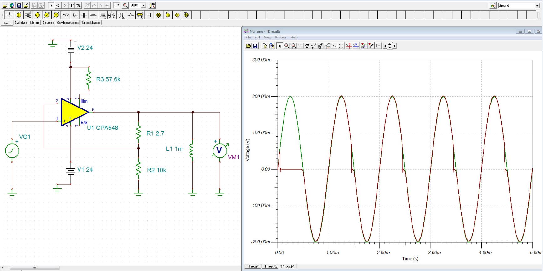

My customer was previously using our OPA541 (TO-3) package on one of their designs, however, this device got discontinued, so they are trying to replace it with something like our OPA548T. The problem is that the OPA548T appears to have a problem with driving inductive loads. It basically breaks out to spurious operations on the negative rail when driving 1kHz sine wave into a 1mH load and it likes to oscillate. Note that the OPA541 was able to drive this load pretty easily.
Attached are two captures. One shows the bench setup which has a heavy inductive load and simulation results which has distortion. The other shows the real bench results which has even worse distortion. They can use in-loop compensation or out-loop compensation or other techniques to make it better, but this is not what they would like to do. They really need a device t work in their existing design without any modification related to the stability loop. Do we have other options?
Key specs were +/- 24V rail, would like output to support rail - 4V, 1-2MHz unity gain bandwidth, and at least 0.5A output current.
