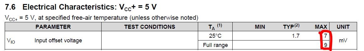

Hi Team,
Samsung washing machine team is interested in using LMV324 to sense the feedback current for motor.
They would like to know the offset voltage(7mV and 9mV) in datasheet is actual value or just guaranteed value.
That's because only if the offset should be lower than 7mV, they can use LMV324 for this application.
Would you provide the offset data and let me know the actual value?
Sammy
  • Sammy,
    LMV324 data is temporarily unavailable. I did find LMV324S data that should be the same.
    LMV324 data will be similar, most devices will be well within the limits. On rare occasion there will be an amplifier that is close to the limit.
    Keep in mind that VIO is based on small random mismatches between otherwise matched components in the amplifier's front end.
    Therefore there is no correlation between the four amplifiers in the same device.
