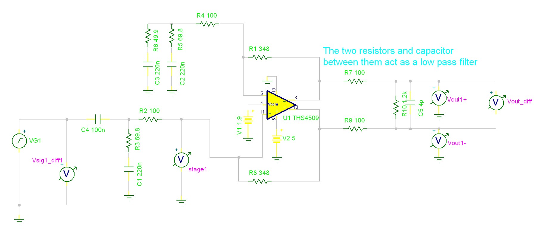

  •  Hello Samir,
               As per your advise, we modeled the opamp. May I ask you to please advise on how the differential input of the ADC can be modeled?
    This is what we did,
    R10 (1.2K) and C5 (4pF) in the right hand side of the schematic (the datasheet of the ADS42LB69 says the ADC differential input resistance is 1.2K and differential capacitance is 4pF).

     1. Page 61 of the ADS42LB69 datasheet shows how the input impedance is modeled and it is how you have modeled it. I am confused by Figure 111 which shows resistance varying across frequency which makes no sense. I would recommend contacting the high-speed ADC team on their E2E forum to clarify these graphs.
    2. I am not sure how the ADC performance varies, however the amplifier always performs better with a lighter load. A lighter load also means less attenuation. For example currently the attenuation from R7 (100 ohm) and 1/2 of R10 (600 ohm) = 600/700 = 0.86 and the amplifier drives a differential impedance of 1.2k + 100 + 100 = 1.4kOhm. Now imagine if the ADC diff input was 200 ohm. With the same circuit the attenuation would be 1/2 and the load would be 400 ohm. So in summary to get the same level of signal at the ADC inputs the amplifier will have to drive a larger signal while simultaneously driving a heavier load. This degrades the amplifiers linearity performance (HD and IMD).
    3. Correct,  there will be a low pass filter.
    4. Yes usually there is a shunt capacitance, but in those cases the ADC input impedance is low and the external amplifier usually drives the ADCs sampling cap directly. In that case an external charge-bucket shunt capacitor is used in order to charge the ADCs sampling cap. You can read more about it here.
    In this case however there is an internal buffer (Figure 115) so no charge bucket cap is needed. Again you can confirm this with the ADC team.
