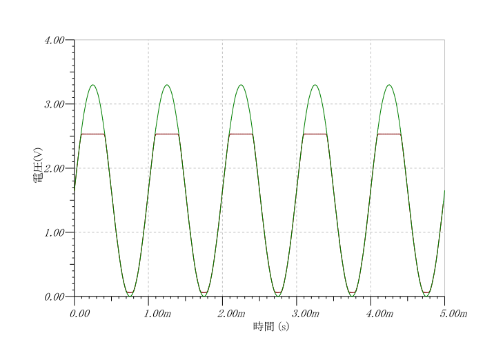

Download LMV842 Spice model,I simulated with TINA-TI.
The result was that the characteristics of "RRIO" were not good.
The power supply is 3.3V, the input signal is 0-3.3V @1kHz with an offset of 1.65V.
Please provide SPICE model with "RRIO" characteristics.
