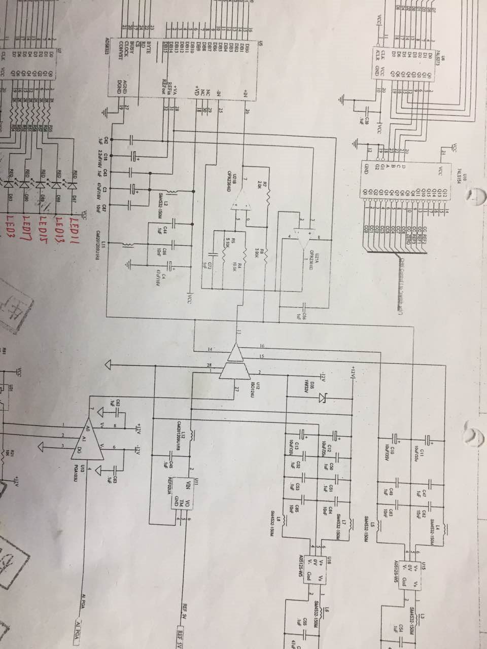

Hi team,
My customer is using the ISO124 now and meet some problems.
1.The weird  phenomenon :
0 mA input., output is 8000, spec says 7FF9~8006
20mA input, output is C000:spec: BFF9~C006
The output is changing and over spec.
The failrate is 62/1801=3.45%
Could you please help me check it and give some suggestions?
