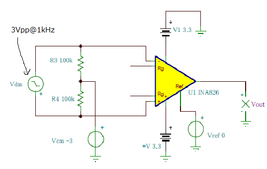

I simulated the common mode volatge range of INA826.
I simulated the characteristics of Figure19 in the data sheet.
When VIN =±3V, Vcm =-3V, Gain =1, we expected that ±1V (blue line) will be output to the output,
but ±3V was output.
In the same way, we simulated with TINA-TI to confirm the characteristics of Figure 9.
When VIN =±2.5V, Vcm =1V, Gain =1, we expected about ±2.2V (red line) to be output to the output,
but ±2.5V was output.
Is TINA not able to simulate the common mode voltage range of INA826?
