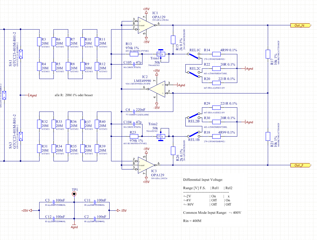

I need an amplifier, differential in, differential out, three ranges 80V, 8V and 2V, common mode range of +-400V, 400M Input Impedanz. I found an solution, but the Offset is very high expecially in the 2V range. How can I fix that?
I built 4 boards, the Offsets are very different, no idea why.
Here the results.

I am not sure which op-amp is good for the servo stage.
I also need a very high capacitor to stop oscillations of the servo loop, here I need also some help.
Here my schematics:
Thanks for helping out.
